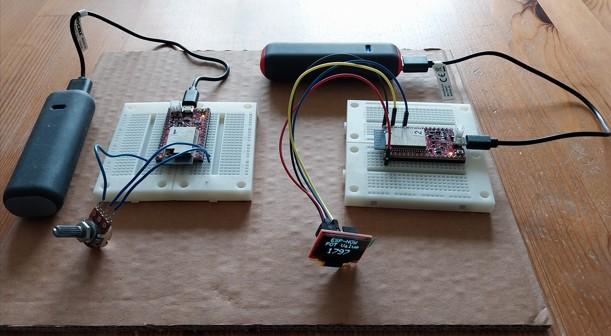

Hello
I tested ESP-NOW 2024-05-06, and it worked quite OK. I observed that it works.
I now have a need to wirelessly read signals from a CNC machine.
One question I have is: Can something similar be done in MMBasic (PicoMite 2W)?
/Peter63
