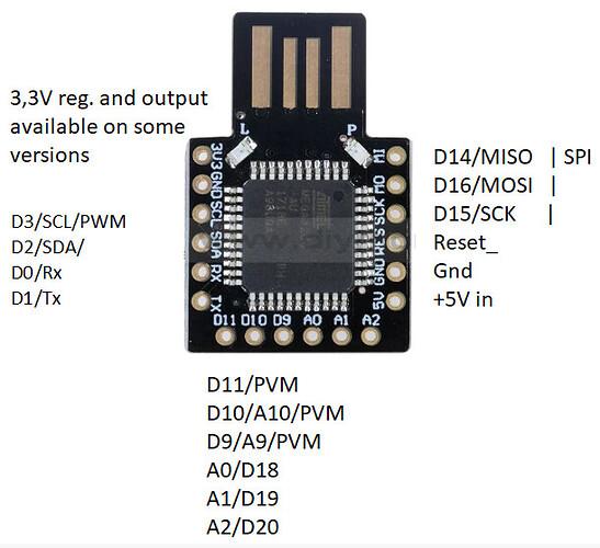

I am using the Arduino Leonardo know as BadUSB to give me keyboard and mouse
operations with the push of a single key.

 I am using custom mapped alt+x keys to do things as I can not use my right
 hand yet. Here is my Minecraft 5 button arduino device. Saves me a lot of
 typing that is hard to do one handed.
