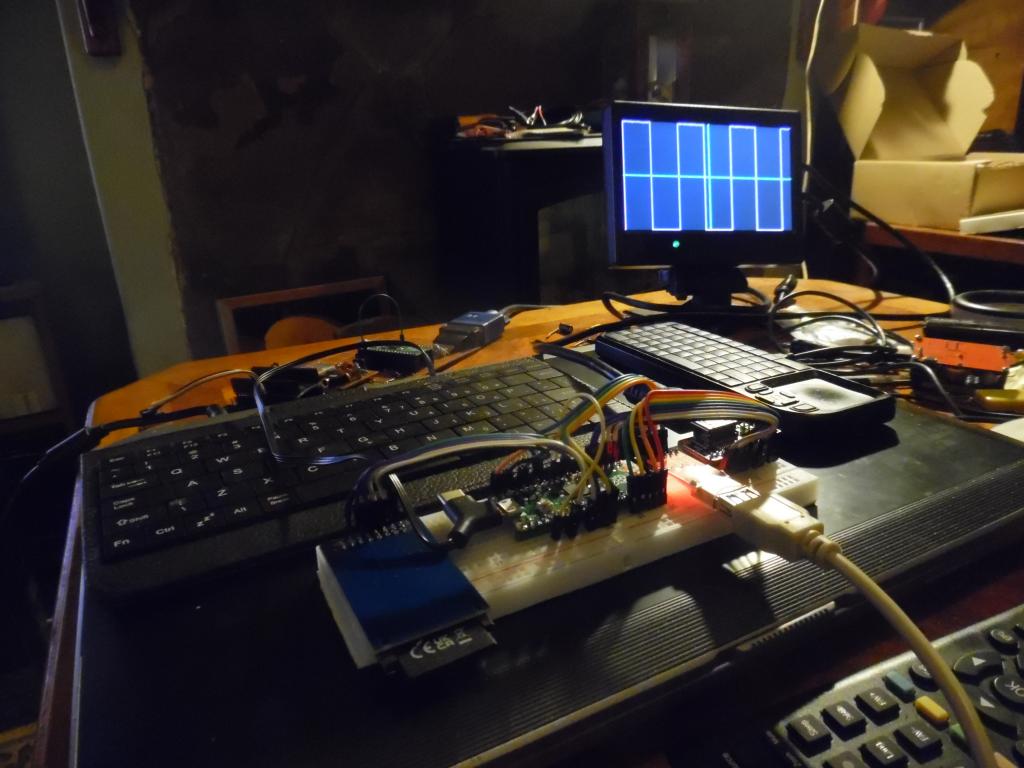

idiot I am connected gp2 to gp26 and I got pwm wave on screen

why was this so difficult? for me, losing it?
