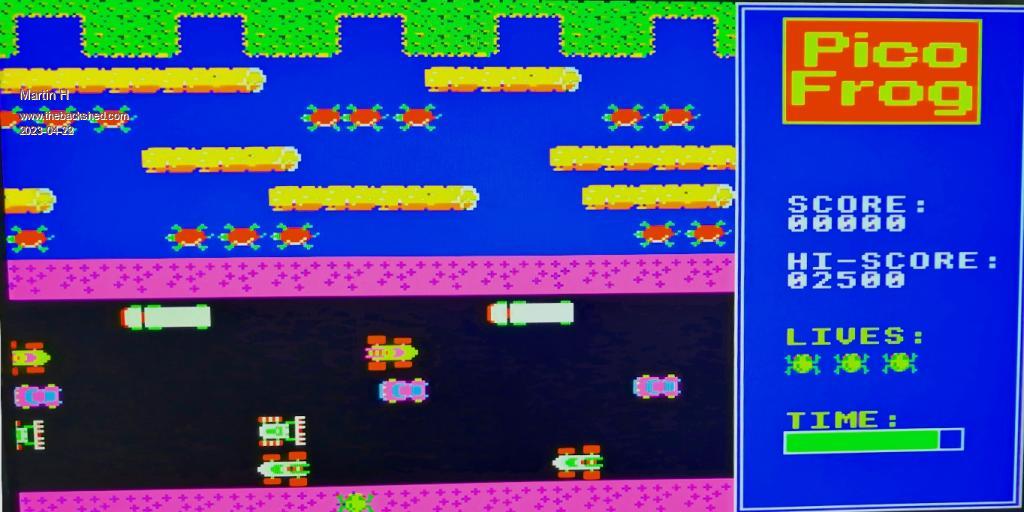

The playable version of a Fogger style game for the PicoMite VGA.
The concept of Frogger is simple. Just get that frog from A to B. Yet it’s a challenge to execute.
The Game:
Move your frog carefuly. Avoid the moving vehicles. On the river, jump across the logs to get your frog to its “frog home”. There are five of these homes, so you have to repeat this four more times.

This is the basic structure of the game. What is missing  in this Version are levels, lady-frog, crocodiles, Beaver, Flies and diving Turtles. So there is a lot of room for improvement. Developed on PicoMite Version 5.07.05RC..
