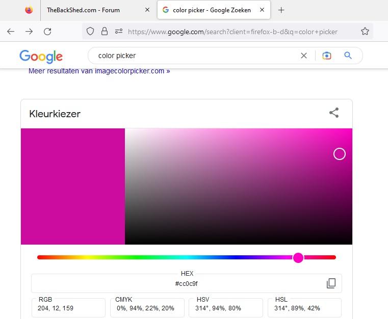

Posted: 07:02pm 03 Mar 2023
Google is your friend !!
In Google just search for color picker and
Move the dot and slider and you can pick any color you want and get RGB, CMYK, HSV and HSL values.
