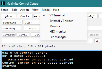

The normal mode is VT Terminal. All text from the device is sent to the terminal and keystrokes made in the terminal window are sent to the device.
Macros and command line text is also sent directly to the device. The command  line box has a command scroll back buffer which make sending repetitive commands easy.
Many system messages are also sent to the terminal window.
External VT helper assumes the an external terminal program such as TeraTerm is connected to the data port. All data is transferred between the attached device and the terminal program. Additionally, you can send macros and other commands etc from the Control centre without interrupting the terminal session.

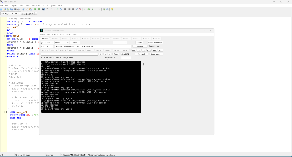

Started Teraterm, connect to com8 of PicoW.
Works.
Configured  external VT Helper.
Tryin Upload fails:

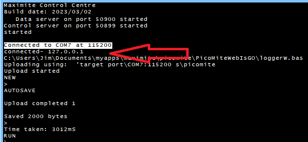

Posted: 08:16pm 02 Mar 2023
You have to connect TeraTerm to MMCC, not the pico.
connect TeraTerm to TCPIP localhost port:50900
I need to see where you have connected!
