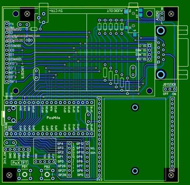

Preliminary idea, but buildable.
I think you'll get the general idea.
In this case the joystick port is using GP4 rather than GP14 for Fire, for ease of connection. It may be of interest to those interested in writing LCD games, but there is enough IO available to be useful, I think.
