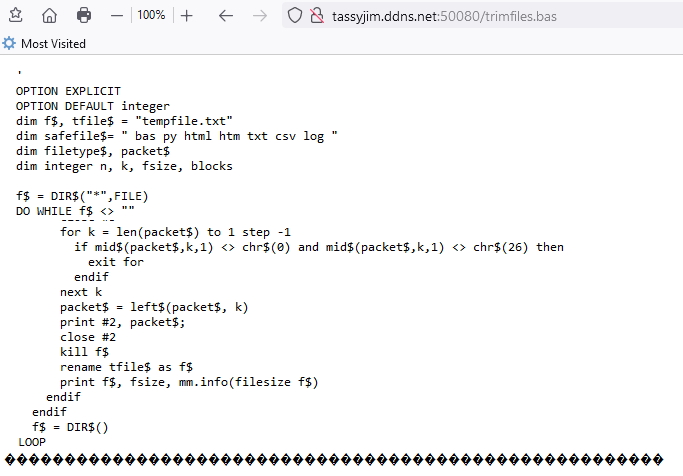

XMODEM has served us well for 40 years but it does have one undesired effect.
XMODEM sends data in 128 byte packets and the final packet gets padded out to 128 bytes with either chr$(0) or chr$(26). Either is valid and it will depend on the sending program so you have to be prepared to handle both padding characters.
This padding is not normally a problem. MMBasic doesn’t care and I have yet to see an image format that gets confused.
If you are using a file for data storage and APPEND to the file, and the file has been padded, you are likely to have problems reading the data.
This Basic program strips the offending zero or ^Z characters form any file with an extension in the safefiles list. I am not willing to trim graphics or data (bin etc) files but if you have one that always ends with a standard ASCII character such as <CR>, you can add the extension type to the list.
The program checks the extension and file size. The assumption is that if the filesize is not a multiple of 128 bytes, it has not been transferred by XMODEM.
Only the last 128 bytes are checked to save time and XMODEM will not add any more than 128 characters so that is a valid decision.
It runs on all files on the current directory

I know the problems, since I edit programs in the build in editor to remove the last bugs (main development is in MMEdit) and then transfer back to the PC environment. I normally use a "notepad" alike editor to remove the trailing 0x00's and save the file again with same name.
Thanks for this tool. It may come in handy.

  Volhout said
Does MMCC file manager fix this also ? Trim the extra 0's ?
Not yet.
The previous versions (pre 5.0) did have the option to trim when you transfer files to the PC. I will probably add the option to the current versions.
The method used was to retrieve the file size before transfer and trim all files to that size.
The problem arises if you hadn't trimmed the file previously and the file size includes the padding.
I will have to get smarter this time.
When you open a bas file in MMEdit, the padding does get trimmed.
