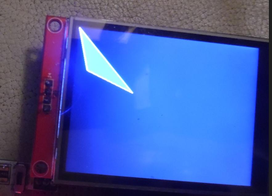

This works for me. yellow triangle filled blue. ili9341.
last beta

Paul, Hi. I'm using PicoMiteV5.07.05b18. This fixed a ssd1306 problem.
which picomite version are you using?
I always use colour abbreviations and this was fine on my ili9341.
I will try real colour values like rgb(255,255,0) for yellow and rgb(0,0,255) for blue
and retest.
regards stan

triangle 0,0,100,100,20,70,rgb(255,255,0),rgb(0,0,255) also works fine.
It is yellow triangle filled blue on black background.. camera not good.

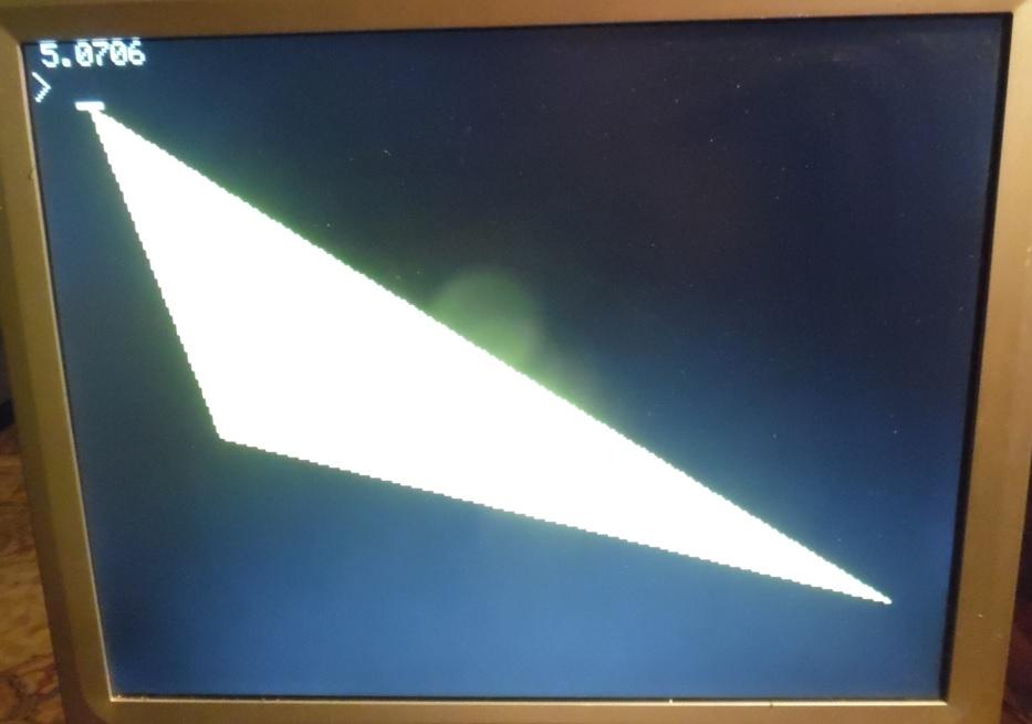

Ah, problemo with vga, it fills with triangle shape colour ie yellow in this,not blue.
mode 2
OPTION BASE 0        ' 0 based arrays
option DEFAULT INTEGER
OPTION EXPLICIT
const WH =RGB(255,  255,  255) 'WHITE
const YE =RGB(255,  255,    0) 'YELLOW
const LI =RGB(255,  128,  255) 'LILAC
const BR =RGB(255,  128,    0) 'BROWN
const FU =RGB(255,  64,   255) 'FUCHSIA
const RU =RGB(255,  64,     0) 'RUST
const MA =RGB(255,  0,    255) 'MAGENTA
const RE =RGB(255,  0,      0) 'RED
const CY =RGB(0,    255,  255) 'CYAN
const GR =RGB(0,    255,    0) 'GREEN
const CE =RGB(0,    128,  255) 'CERULEAN
const MI =RGB(0,    128,    0) 'MIDGREEN
const CO =RGB(0,    64,   255) 'COBALT
const MY =RGB(0,    64,     0) 'MYRTLE
const BL =RGB(0,    0,    255) 'BLUE
const Bk =RGB(0,    0,      0) 'BLACK
const Gy =RGB(128,  128,  128) 'GREY
const Lg =RGB(210,  210,  210) 'LITEGREY
const Og =RGB(255,  165,    0) 'ORANGE
const PK =RGB(255,  160,  171) 'PINK
const Gd =RGB(255,  215,    0) 'GOLD
const SA =RGB(250,  128,  114) 'SALMON
const BE =RGB(245,  245,  220) 'BEIGE
cls bk
print mm.ver
triangle 20,20,300,200,55,135,ye,bl
triangle 20,20,300,200,55,135,RGB(255,  255,    0),RGB(0,    0,    255)
