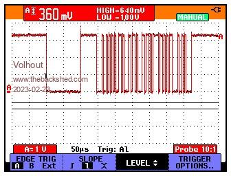

In case you want to implement DMX master in a simple way (using pure MMBasic):
'test COM port 2 for DMX512 transmitter
'uses GP4 as TX pin and GP3 as BREAK generator
'requires external AND gate (74HC08) to combine GP3 and GP4 inot
'1 signal to drive MAX485 driver chip.
SetPin gp3,dout             'pin for BREAK generation
Pin(gp3)=1                  'default is high
SetPin gp5,gp4,COM2         'open COM port (for TX only)
Open "COM2:250000,S2" As #1 'at DMX speed
DMX$="Hello"
 Pulse GP3,0.1             '100us break
 Print #1,DMX$             'send data
 Pause 100                 'pause for trigger
Loop
Above code will use pin GP3 to generate the BREAK signal, and GP4 (COM2) to transmit the strings. You have to combine the 2 signals in an AND gate (i.e. 74HC08, pin 1-GP3, pin2-GP4, pin3=DMXout). That may seem as a extra chip, but since you will have the add the MAX485 driver chip anyway, it is just 1 more chip on the breadboard.
Waveform (100us BREAK) on my breadboard (sending string "Hello" at 250kbaud);
If you change the content of DMX$ to your liking, you should be ready with these few lines of code.
Edited 2023-02-23 20:39 by Volhout

' citing Volhout:
' How does this work in MMBasic ?
'Each time you update a DMX universe you have to
'- start the PIO, so it inits and sends the BREAK
'- start feeding up to 512 bytes to the FIFO with PIO WRITE 1,0,value%
'- wait a bit between each byte (more about this later) but you can start with PAUSE 0.1 (100us)
'- STOP PIO 1,0 (stop the state machine)
'- Re-init the state machine (PIO INIT MACHINE 1,0,f,p,,,0) so next time it starts at 0 (lable: init_break) again.
'In case you have this working, you can use the PIO DMA to automate stuff for you.  (tom_g: at this stage now)
' tom_g: remains to do
'The DMA will do the waiting between bytes, and start the machine for you.
'Assume you have XX bytes (max 512) in array DMX%(), the process will be
'Each time you want to update the universe
'PIO DMA TX 1,0,XX,DMX%(),I_am_done
CONST i_max = 12
DIM value%(i_max) AS INTEGER = (12,23,45,33,40,41,43,45,65,44,46,47,49)  ' test data just for debugging
DIM i AS INTEGER = 0
'main
 PIO START 0,0
 PIO WRITE 0,0,1,value%(i)  ' send a byte
 if (i < i_max) THEN
   i= i+1
 else
   i= 0
   PAUSE 10     '10ms interbyte delay for scope testing
 ENDif
 PAUSE 0.1     '100us
 PIO STOP 0,0
 PIO INIT MACHINE 0,0,f,p,,,0
