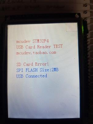

I purchased some STM32F4 black boards and I have found one of the boards will not program via the ST software. I cannot get the unit to register in the cube software like the other units but if I take off the BT0 and BT1 links the screen displays this:
Can anyone offer any ideas?

Posts: 6606
Posted: 09:51pm 21 Feb 2023
It does appear to have a program installed.
If you can't erase it and load your own, perhaps whoever loaded the original program made it write protected in which case I don't know where to go next.

  Quote  It does appear to have a program installed.
Jim, the unit is fresh out of the bag from the supplier. The units that have programmed with MMBasic are still recognised with Cube software.
