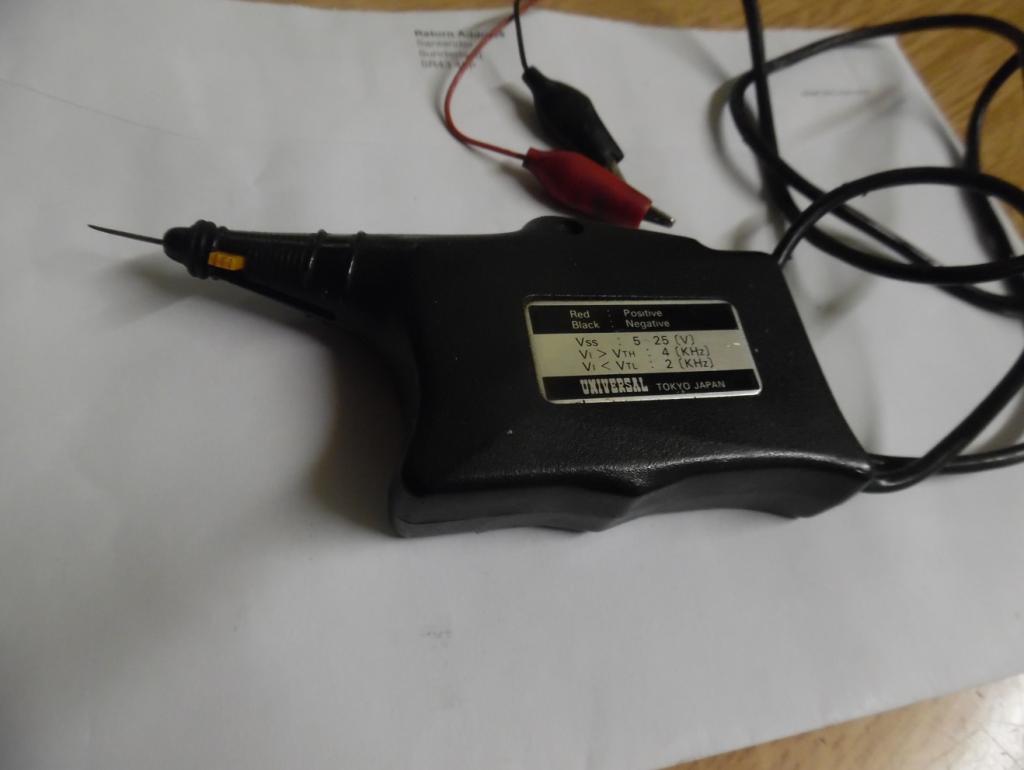

Mick - nostalgia from working in a video games factory that made universal games into cabinets. a free tool for analysing logic.
You were supposed to fix faulty ram with these.

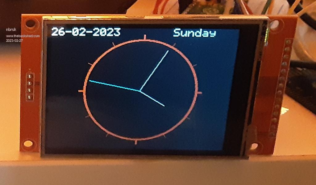

Here the latest version of my clock: In upper left corner the date is displayed and
on the right corner de day of the week:
