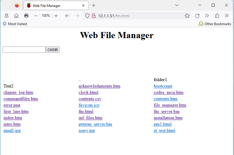

Hi Jim,
Here's the working code for subdirectories:
the page:
<html>
<head>
 <meta http-equiv="Content-Type" content="text/html; charset=utf-8"/>
 <meta name="GENERATOR" content="TheMonkeys">
 <!--link href="dom/core_c.css" type="text/css" rel="stylesheet"-->
 <style type="text/css">
   a{{width:18vw;display:inline-grid;}
 </style>
 <title>Web File Manager</title>
</head>
<body>
<h1 align="center">Web File Manager</h1>
{filename$(1)} {filename$(2)} {filename$(3)} {filename$(4)} {filename$(5)}
{filename$(6)} {filename$(7)} {filename$(8)} {filename$(9)} {filename$(10)}
{filename$(11)} {filename$(12)} {filename$(13)} {filename$(14)} {filename$(15)}
{filename$(16)} {filename$(17)} {filename$(18)} {filename$(19)} {filename$(20)}
{filename$(21)} {filename$(22)} {filename$(23)} {filename$(24)} {filename$(25)}
{filename$(26)} {filename$(27)} {filename$(28)} {filename$(29)} {filename$(30)}
</body>
</html>
Add this to the declarations:
Dim sdir$="" ' subdir
Add this to the top of gotrequest (just the "NEW" stuff - indented code shown for reference)
 Local arg$(1,maxargs-1)
sdir$="" ' NEW
 For a%=1 To MM.Info(max connections)
and here's the updated makelist:
Sub makelist
  Local f$, n, k
  For n = 1 To 72
     filename$(n) = "" ' clear old entries
  Next
  n = 0
  f$ = Dir$(sdir$+"*",DIR)
  If sdir$ <> "" Then Inc n: filename$(n) = ".. ' : Print /+sdir$
  Do While f$ <]
     If Right$(f$,1) <]"." Then ' skip the ./..
     Inc n
     filename$(n) ="<a href='fm.piml?dir="+f$+"'>"+f$+"/"
'Print "_"+f$
     EndIf
     f$ = Dir$()
  Loop
  Inc n
  filename$(n)="
  f$ = Dir$(sdir$+"*",FILE)
  Do While f$ <> ""
     Inc n
     filename$(n) ="<a href="+Chr$(34)+f$+Chr$(34)+">"+f$+""
'Print "-"+ f$
     f$ = Dir$()
  Loop
End Sub
Oops, missed the argument bit
     ' process arguments before returning page with updated results
     If page$ = "fm.piml" Or page$ = "fm" Then
       For i=0 To nparams%
         If arg$(1,i) <> "" Then Print arg$(0,i);"=";arg$(1,i)
If arg$(0,i) = "dir" Then sdir$=arg$(1,i)+"/" ' NEW
       Next i
       makelist
Edited 2023-02-17 12:36 by TheMonkeys
TheMonkeys
Joined: 15/12/2022
Posts: 59
Posted: 02:46am 17 Feb 2023
The
Do While f$<]"
should be:
Do While f$ <> ""
and the
should be:
If Right$(f$,1) <> "." Then
and the
filename$(n)="
is supposed to be adding a "<"BR">" tag. (escaped so that it doesn't get hidden).
Posted: 03:58am 17 Feb 2023
Thanks for the contributions.
I am not going to do too much to the html until I finish debugging with Peter. Too many changes make it harder to compare results.
TheMonkeys
Joined: 15/12/2022
Posts: 59
Posted: 04:39am 17 Feb 2023
Hi Jim,
No worries.
I created a sub directory "dom" and put "core_c.css" in it.
The code navigates into - and out of - the sub directory, shows the files, and as you can see in the commented line in my html, the browser successfully loads the file from there.
I'll leave it at that for now.
Cheers,
Chris.
