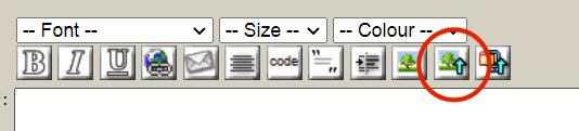

I am a newbe! Can someone please advise me how to add a JPG image to a posting?
Many thanks

Above the text entry field there are icons. Select the green one with the blue arrow in it.
A popup lets you select the file.

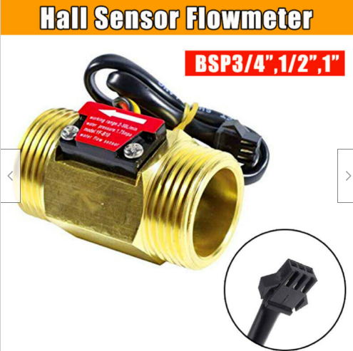

Using a water flow sensor would be a lot easier than monitoring the current.
I used to use the ones from Jaycar but found that they only lasted a couple of years.
I currently use these:
https://www.ebay.com.au/itm/304598403631
I have 4, monitoring house water, garden, stock and bore.

Thanks for the method of attaching an image. I got link information to the image in the message box as you illustrated but as I didn't see an image, I assumed that I was doing something wrong. So, I'll try again. here it is:

What image format are you using?
Note that when you insert the image into your text you don't see the image itself, just a link to where it's been copied to by the forum software. You don't see the image itself until you post your message.

The link was a link to YOUR PC file system.
You have to use the button with the up arrow and then a popup opens where you upload your image.
