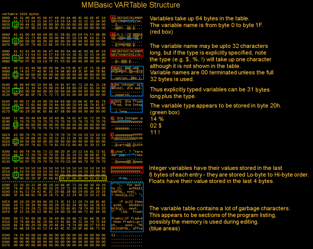

Whereas there is plenty of scope for diffent datatypes, the core code of MMBasic would likely require extensive reworking to accomodate them and the various type checks fr mismatches etc.
From my PEEKings back in November; a variable entry in VARTABLE  is 64 bytes long, integer values only occupy 8 of those bytes (yellow box). Floats occupy four bytes. A theoretical single byte datatype would possibly occupy one but the entry for the variable would still be 64 bytes long. No memory saving would be realised if the same scheme were followed.
The following is far from complete and possibly inaccurate. One question remains: How do I tell where the end of the vartable is (i.e. how many variables have been definded?)
Edited 2023-02-12 07:36 by CaptainBoing

Posted: 11:21am 12 Feb 2023
Sorry, yes, this is on MicroMites. As I understand it the method of handling variables on the Pi and CMM2 are different so that might not apply.
I have gone through the source code (as well as I can - not a C programmer) and cannot see any way to detect the end of the table so a counter would explain that. I generally search 2048 bytes in 64 byte chunks which allows for 32 variables - probably about right for most tasks. I might add I am probably making a mountain out of a molehill here as I don't often piddle about with this stuff in my code.
"Cleaning" the table is a nice idea but we are back to the "how far can I go?" problem - don't want to trample on stack or anything important... trial n error I guess.
