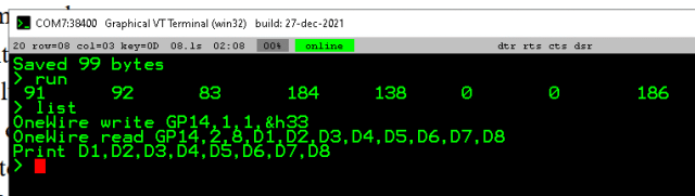

OK, my chips have arrived from element14, so I got to work playing with one right away, keen to learn something new, as I have never used the OneWire protocol before now.
First test was a success!
Does that bode well, or was it a fluke!
In this test, all I wanted to try, was reading the device's unique 64-bit ROM code.
To keep things simple, I just read the 8 bytes as separate variables.
The manual(page 7) shows that the first byte is a CRC code, then the next six bytes are the actual 48-bit serial number, followed by a one byte family code.
Keeping things VERY simple for me at this stage, I am still using decimal, but it would be easy to repeat the test and get HEX results.
I have to go to a job now, but I will be back for more tinkering later!
