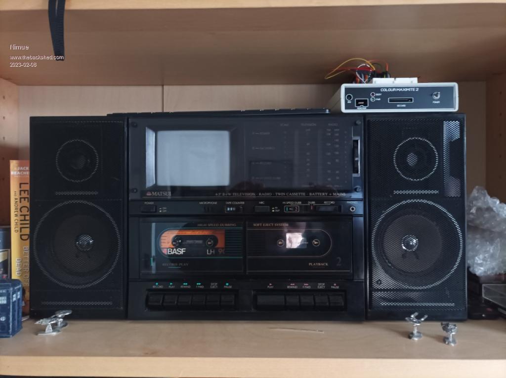

How much geek in one photo ;-)

That is true geekery in all its beauty. :)
I've not seen one of those Matsui boxes for ages.

  Mixtel90 said  That is true geekery in all its beauty. :)
Not shown but the RF in is a great match for my Zeddy and Speccy.  B&W of course!
Another rabbit hole for the weeked.

I really approve of the little Tardis too. :)
