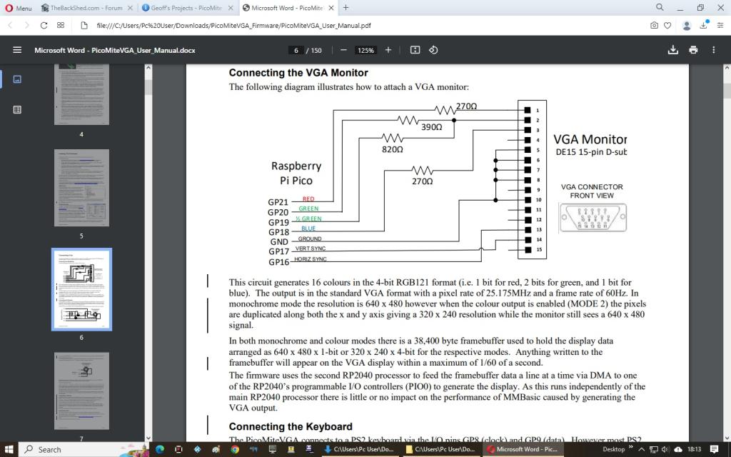

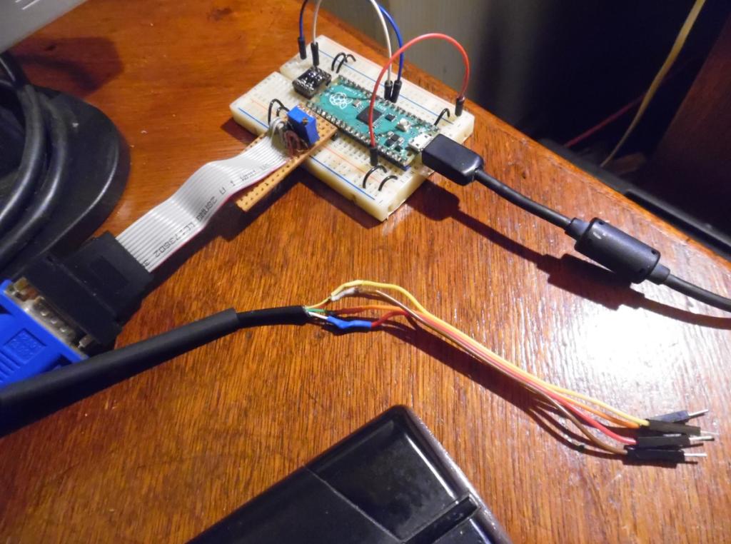

Hi. I finally decided to try picomite vga so built the vga 16 colour circuit.
It did not display anything but teraterm works. This is v5,07,07,b1.
I found a new vga manual and a much simpler circuit for 16 colour vga. No potentiometer or diodes.
Bit late and no mention of 8 colour vga.
Posts: 12183
Posted: 06:37pm 01 Feb 2023
Both versions work equally well if wired correctly and both are 16 colour. Does Teraterm say PicoMiteVGA in the title - if not you have loaded the wrong firmware

If it doesn't say VGA then you probably have the wrong firmware loaded. Both versions come in the same zip file. You might like to try a non-beta version to prove that everything is OK. https://geoffg.net/picomitevga.html
The 4-resistor system works well, by the way, and produces 16 colours. There isn't an 8-colour mode.

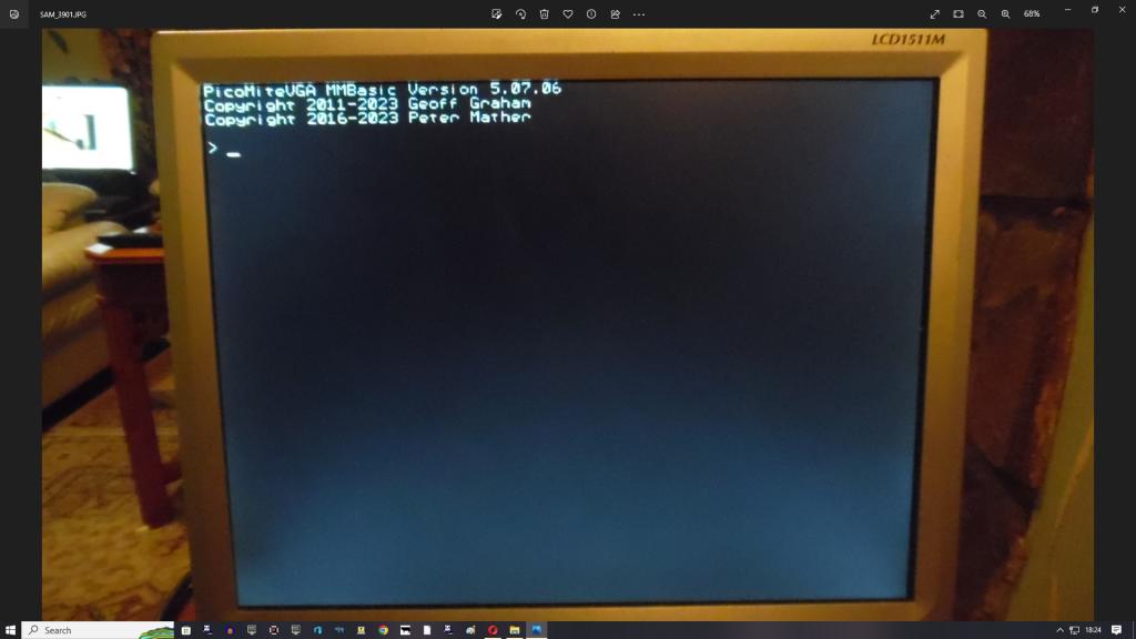

PicoMiteVGA MMBasic Version 5.07.06
Copyright 2011-2023 Geoff Graham
Copyright 2016-2023 Peter Mather
Thanks, me doh!

anyway my vga was duff vero/stripboard problem so why redo it when 4 resistors will do?
I use vga sockets from graphic cards because they don't mount on vero/strip board but these got leads and plug sockets.
I'll make another board/adaptor and see.

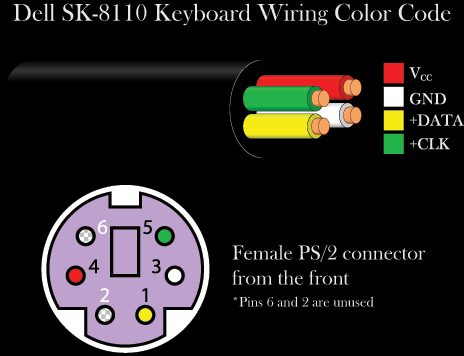

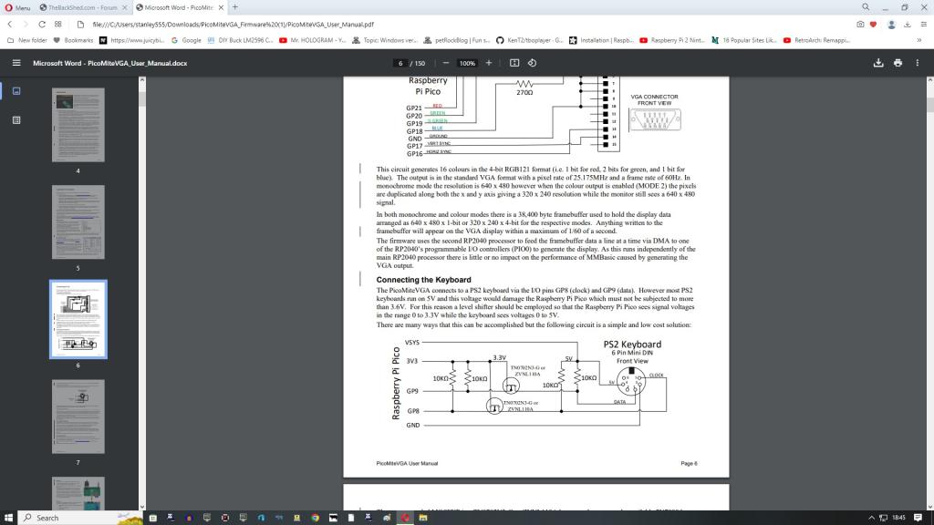

keyboard is tricky. ps2 sockets on vero, no it's wiring ie cut off ps2 plug and using logic level converter.
If it works all I want is write reto games. Will more than 1 key work at once?

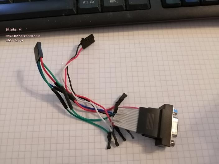

Posted: 01:47pm 02 Feb 2023
Hey Stan,
Please check twice, if you have used the correct pins on the VGA socket.Maybe it is mirrored.
my first test attempt was simply a wired connection from a socket to a VGA socket left over from an old card with the resistors in the Cable.
ugly but done its job.
Edited 2023-02-02 23:53 by Martin H.

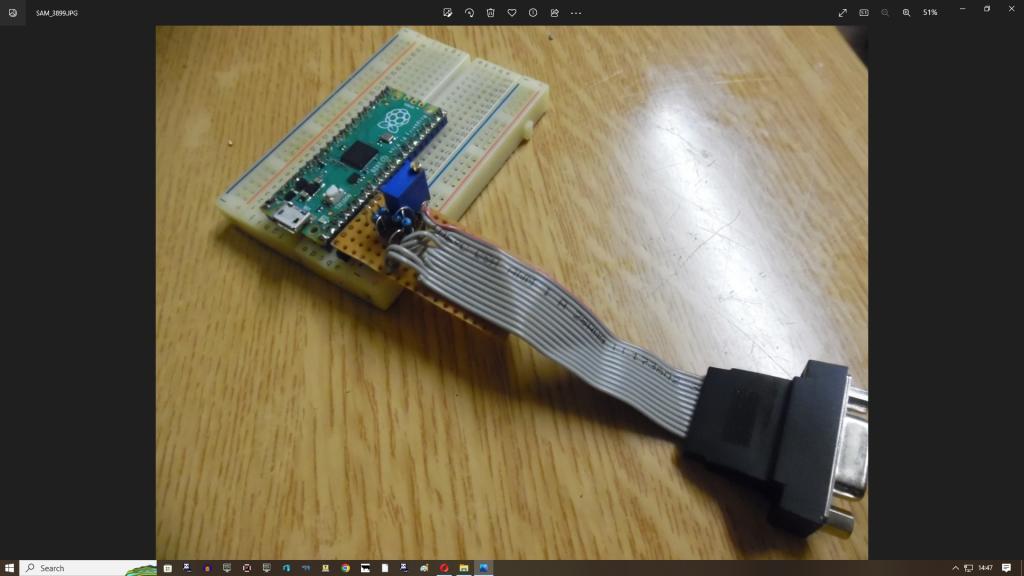

Hi Martin. my vga was like yours but the lead went to vero that plugged into a breadboard with the 8 pins matching the 8 pins on the pico syncs,gnd,4 colours and gnd but the header lifted the vero copper and probably not worth fixing so I'll try the 4 resistor option.No diodes or 220r pot. I would have anyway if I'd known there was a new pico vga manual.
My vga plug looks like yours and the resistors would fit inside.
stan.
I can post pictures in chrome but not opera anymore?
Edited 2023-02-03 00:56 by stanleyella

Posted: 05:26pm 02 Feb 2023
your VGA connection is on the Wrong side.. turn the Pico 180°
'no comment

Posted: 05:57pm 02 Feb 2023
You are correct, it was just for a photo to get to post. It does align other side.
The board has broken tracks due to insertion header pressure.
Looking for the 4 resistors to make a new vga lead. Looking forward to seeing it working.
cheers, stan

Posted: 06:29pm 02 Feb 2023
I fixed the broken vero strip, which was ground and I got a picture. Now the fun.

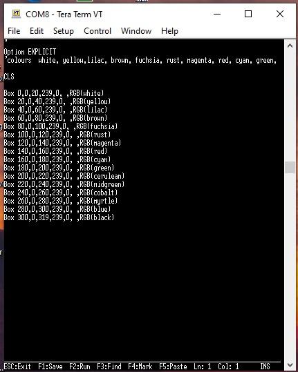

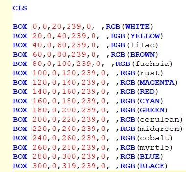

I tried
using mmedit and noticed only primary colours get capitalised.
The monitor only showed 14 boxes but after head scratching I pressed a button on the display marked "auto" and it displayed 16 boxes.
Posts: 9329
Posted: 03:52pm 03 Feb 2023
The capitalisation isn't a function of MMBasic AFAIK. Have you tested to see how it looks in the built-in editor?
Looks like your monitor hadn't synched properly at that resolution.
Edited 2023-02-04 01:53 by Mixtel90

I type edit in teraterm and got this and on the vga display. The inbuilt editor is amazing but I'm too lazy to learn it and mmedit is like gcbasic and picaxe editors on win.
