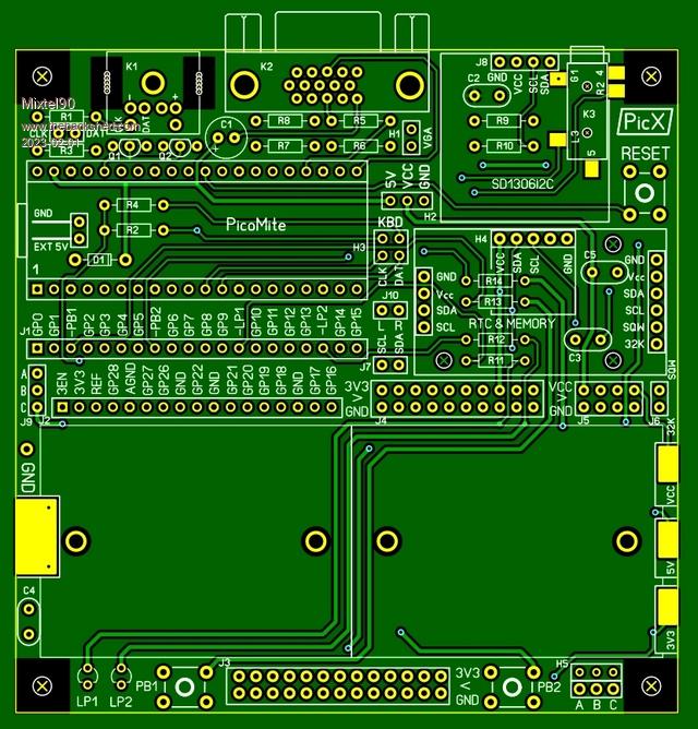

Born out of frustration. :)
Of course, it's 100mm x 100mm.

Cool, I might have a go at building one.
Note in order for the 3.3v switch mode chip to be disabled and its output substituted by an analog PSU, by taking its 3.3_EN input low, it has to have power on the VSYS input pin, so the chip is active and can respond to the low on the 3.3_EN line.
Mike
Posts: 8913
Posted: 08:32am 01 Feb 2023
It normally would have as the 5V supply would be via the USB input. VSYS is fed from VBUS via an on-board diode. The Ext 5V input does the same thing. It's not visible in that pic as I switched off the bottom copper layer to make it prettier. :)

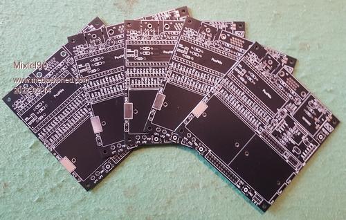

Posts: 8913
Posted: 09:18pm 13 Feb 2023
JLCPCB came up with the goods this morning, so a new toy to play with soon. :)  Dry assembly has been ok so far, which is a good thing. I have some bits (including the breadboards) on order. The jack socket is going to have to wait until I can make up a sensible order from RS.

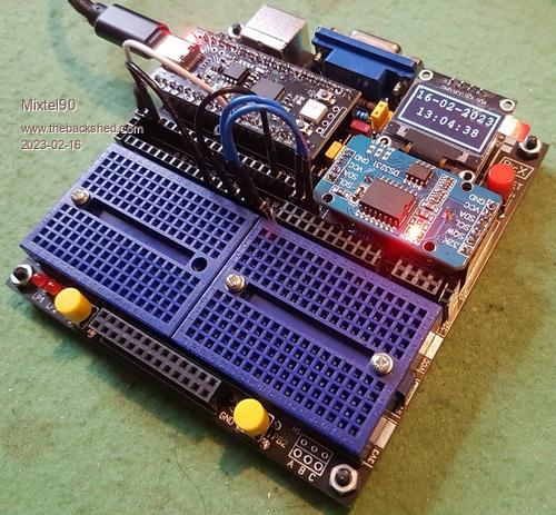

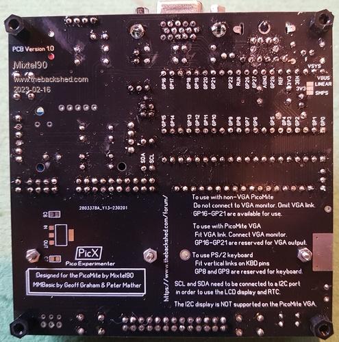

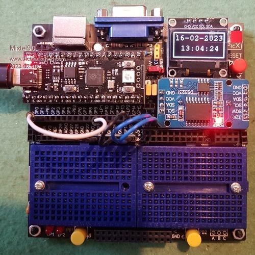

Posts: 8913
Posted: 01:33pm 16 Feb 2023
Laydees an' Gennelmen! We have a prototype for your delectation!
Please excuse the flux grunge - I've no flux remover and isopropyl alcohol makes the board sticky.
If you need more breadboard area you can expand it at the right-hand end, just directly outwards or with more breadboards above and/or below the first one.
This is also a pretty good illustration of why you should avoid black or blue breadboards - the holes are harder to see. :)
Incidentally, the two blue Dupont leads are connecting the I2C bus to the PicoMite (a YD-RP2040).
Not tested with VGA and PS/2 yet.

Looks like another great board to play with - thanks.
What Pico board is in the pictures? How is it different from a Raspberry Pi Pico?

The Pico alternative is the YD-RP2040 from Ali Express. Very briefly:
USB-C connector
16MB flash
WS2812 LED on GP23 (if you close a link). GP23 is also on a pin.
Reset button
User button (GP24)
Power LED
ADC_VREF has moved, not on a main pin now. Replaced by ADC3
Linear voltage regulator. Means that minimum input voltage is higher (3.46V).
No 3V3_EN now.
It's not as fast as an official Pico, in that you can't overclock it as much. Apart from that it seems to be ok. The power arrangements are a bit different - you can't take 5V from pin 39 as it's a VIN with a diode now. (For this board it's a good idea to short out pins 39 and 40 on the module itself.)
I'm in the process of updating the "manual" for it, in light of the things I've come across while building the prototype. I've not found any board errors so far.
