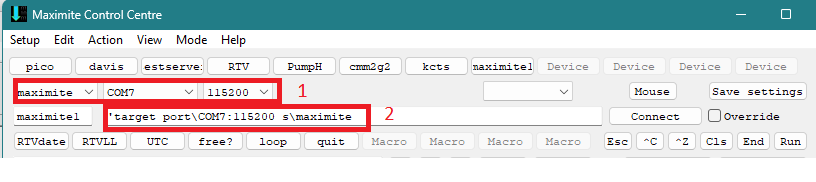

You didn't "connect" to your maximite first. This is not usually needed but it will help me diagnose things.
Look at the line "Uploading using:"
You don't have the baud rate and (most importantly) the "device type" set.
You have to set the device type , port and baud rate. (1)
These setting must appear in the device specifications text box (2)
The only other way the program gets the specifications is from the first line of your program but don't go there yet.

The MMCC is a separate program. You should have a desktop shortcut for it if you installed the MMEdit program. It is also in the Windows menu under MMEdit.
If you are running the portable version, you will have to find MMCC.exe in the program folder.
It doesn't matter. MMEdit is starting it for you. Don't worry about the failed attempt in the terminal window.
Once MMCC is running, do you see the things in my photo from the earlier post just above the terminal screen?
if not, turn each row on from the 'view' menu.
Make sure your settings look like the ones I have in the photo then click on "Connect"
Then leave the MMCC window open and press the "Load and Run" in the editor window.
I want to se the Maximite copyright text and everything after that...

reults as foll
Ist row box 1MyMite
2nd row  box1 Maximite
Box2  com7
Box3  9600
3rd Row box1 Mymite
Box2 'target port\COM7:9600     (    Note “MAXIMITE” not Showing as your screen shot
Box 3 disconnect
Then screen shot as foll:-

You could always add  s\maximite to the end of the device configuration box but first try selecting maximite from the pull-down list again. If that doesn't work, select a different device and then select maximite again.
What version of Windows (or Linux) are you running?
jeffj
Joined: 04/02/2012
Posts: 84
Posted: 06:08am 20 Jan 2023
Thats got it .
typed S\maximite and now works ok
