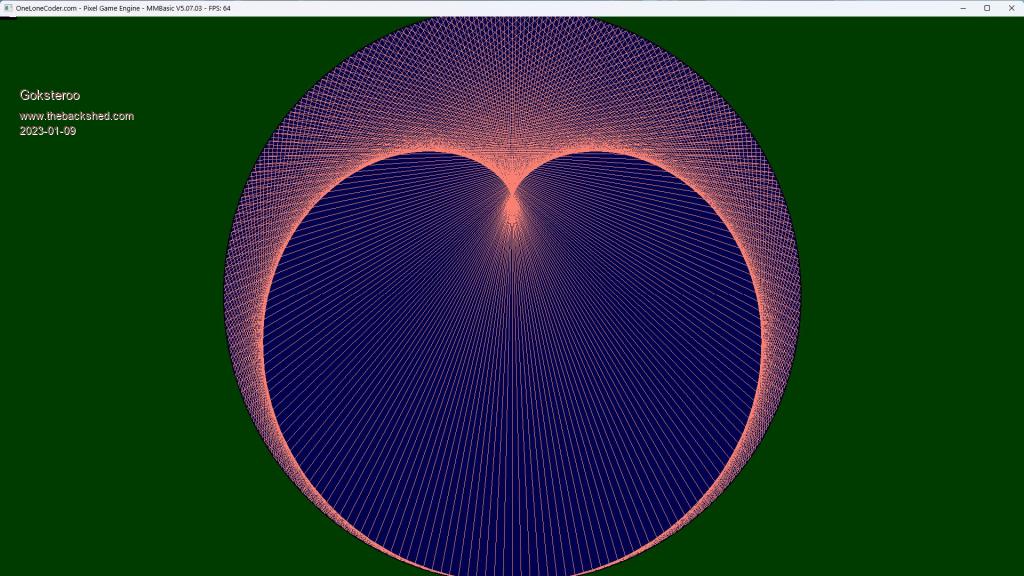

A long time ago I watched this video on YouTube and was fascinated by the animations he produced - very hypnotic.
https://www.youtube.com/watch?v=qhbuKbxJsk8
This video is not new and I was reminded of it when I saw a short Basic program on FaceBook to reproduce the graphics/animations. Of course I had to convert it to MMBasic. My CMM2 has issues so I have used MMB4W, but it should work on all versions with minor changes. Adjustable parameters are explained in REMs. Animation will pause while any key is pressed.
Enjoy.

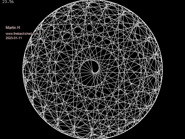

here my adapted version for PicoMite CPUSPEED 378000 in Mode 1

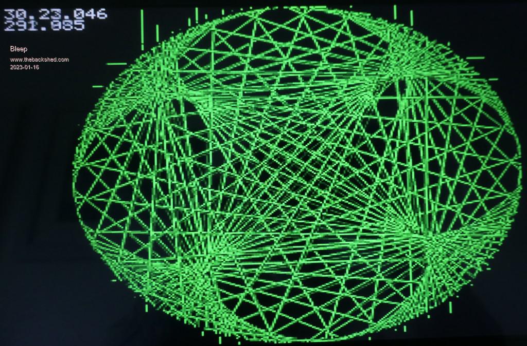

If I use Martins method of only clearing the circle, not a full CLS, if you run your AA version for a few minutes you get artefacts outside the circle, straight vertical or horizontal lines. Remove the AA option and you don't get these. This is on a VGA Picomite.
Regards, Kevin.

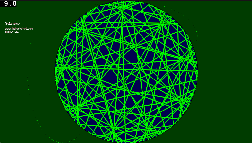

Here is a pic to show the artifacts when using LINE AA  - at least with MMB4W. This is done with a line width of 4. Note there are also extra pixels within the circle as well.

Posted: 03:31pm 15 Jan 2023
Hi Peter,
Thanks for the update with some Pixel drawing fixes, they don't seem to have cured my horizontal and vertical artefacts when using AA, see photo, if you run the code above they will start to appear within a minute or two, at least the do on my Pico.
Regards, Kevin.
