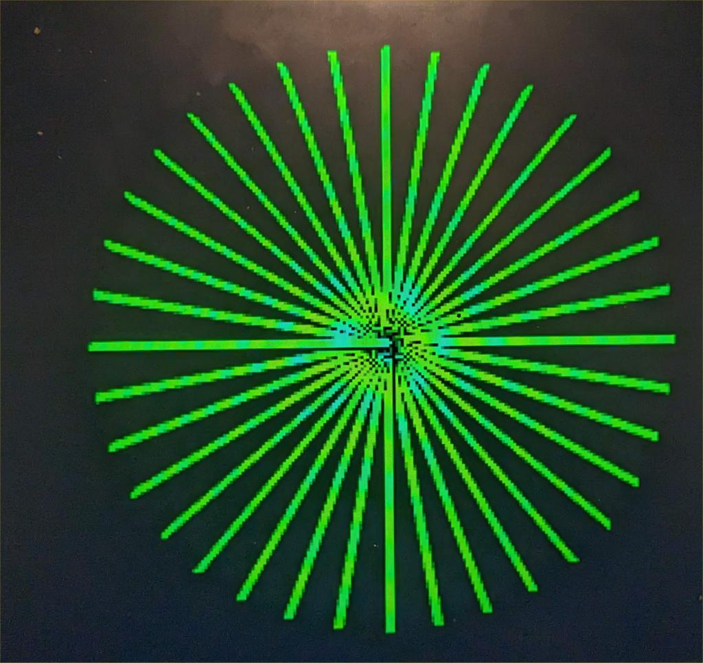

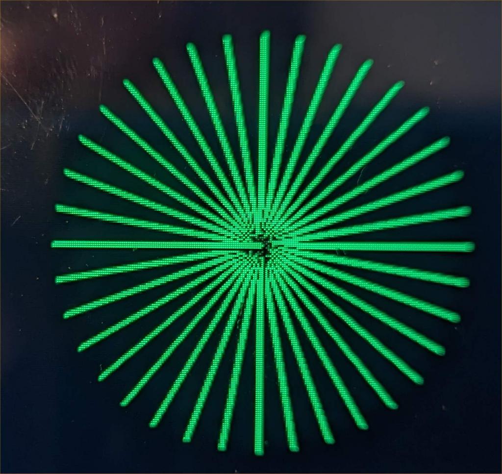

Version 5.07.06RC1
Changes from the last beta
Improved error detection on some option commands to avoid lockups through pin conflicts
Extra optional parameters for PIO(EXECCTRL
PIO (EXECCTRL jmp_pin ,wrap_target, wrap [,side_pindir] [,side_en])
New sub-command
LINE  AA x1, y1, x2, y2 [, LW [, C]]
Draws a line with anti-aliasing . The parameters are as per the LINE command. However this version will use variable intensity values of the specified colour to reduce the “staggered” quality of diagonal lines.
In addition this version can draw diagonal lines of any width.
NB: At low colour resolutions (PicoMiteVGA and framebuffers on the PicoMite) colours other than green may not show any advantage from anti-aliasing and colours including green (e.g.yellow) may show a different shade in the lower intensity pixels
ON ERROR SKIP
MODE 2
For i=0 To 360 Step 10
x=100*Cos(Rad(i))
y=100*Sin(Rad(i))
Line aa MM.HRes\2,MM.VRes\2,MM.HRes\2-x,MM.VRes\2-y,3,RGB(green)
Next
Loop
VGA
ST7789_320

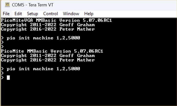

Hi Pter,
pio init machine 0,0,f
PIO init machine 0,0,f,,e,,0
PIO init machine 0,0,f,p,e,,0
PIO init machine 0,0,f,,e,s,0
PIO init machine 0,0,f,p,,,0 not
Only the last one does not work, all other combinations work.
You need "e" (execctrl) when you add anything after the frequency.
Maybe an obscure reason. We can work around it. It was just awkward..

Don't know what version you are running but there is no issue I can see with V5.07.06RC1. Please post an actual example code if you can demonstrate something with RC1

Hi Peter,
try this:
'pio example program
p=0
e=0
f=2000
s=0
start=0
PIO init machine 0,0,f,p,e,s,start
PIO init machine 0,0,f,,e,,start
You can use all combinations for the optional parameters, but you need to provide the EXECCTRL parameter "e"
Edited 2023-01-04 17:07 by Volhout
Posts: 11889
Posted: 07:45am 04 Jan 2023
You can't have trailing commas. This is nothing to do with PIO but is standard MMBasic. Just omit the trailing commas and all works
Edited 2023-01-04 17:46 by matherp

Hi Peter,
This is standard picomite RC1.
A question. What CPUSPEED is the current image running on ?
When I image with RC1 and run above program, I get a remark that PIO frequency must be
2029Hz or higher.
When I set CPUSPEED 126000 then the lowest frequency is 1922Hz
When I set CPUSPEED 252000 then the lowest frequency is 3845Hz
So the CPU must be running (fresh from the imaging) around 133MHz ??
Edited 2023-01-04 17:52 by Volhout
Posts: 11889
Posted: 07:55am 04 Jan 2023
Standard speed for the PicoMite is 133MHz (manual page 10), PicoMiteVGA is 126MHz (manual page 11)
Edited 2023-01-04 17:59 by matherp
Posts: 6122
Posted: 08:01am 04 Jan 2023
@Peter,
Previous example about the "e" parameter (2 posts back) was on an older firmware version. I have checked RC1, and in RC1 the "e" paramater is optional.
Thanks,
