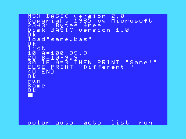

And yet the MSX manages it with ease:
Decimal maths as an option is a required part of the ANSI Full BASIC standard. I don't think anyone's ever implemented it properly: maybe the Decimal BASIC out of Japan does.
Microsoft toyed with using decimal floating point for a while, so the Tandy 100, MSX and one of the early Mac BASICs has it. It's very slow unless you have dedicated BCD float hardware, which AFAIK only IBM Power 9 has
