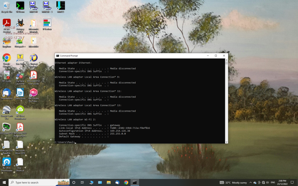

The laptop is connected and works OK. The workshop computer connects to the wifi but has no internet and when I trouble shoot I get the message 'Invalid IP configuration'
Running ipcofig gives me
Posted: 06:45am 23 Dec 2022
Your adapter has ended up with a default address meaning it couldn't find the modem.
From a command prompt
IPCONFIG /RELEASE
IPCONFIG /RENEW
you might need to add ALL to either or both the above commands.

The 169.xx.xx.xx address is a windows default IP address when no IP address was provided by a dhcp server.
In your router is it set to provide a DHCP address?
