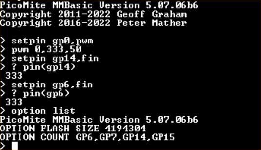

Posts: 6254
Posted: 09:11am 22 Dec 2022
@Peter,
On the standard picomite it works. I can cionfirm.
Phil is running the VGA version, not using the default configuration
Default: gp6,gp7=audio, gp14,gp15=I2C
Phils board: gp6,gp7,gp14,gp15 = COUNT
Maybe there is something not going well becuase this different pin assignment.
I have used Phils OPTION LIST (no RTC AUTO, since I have no RTC) on a bare picomite prograqmmed with the VGA firmware, and see the same.
Edited 2022-12-22 19:13 by Volhout
