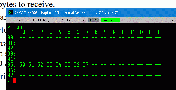

PicoMite seems to know it is there, cos the test code on this thread produces the following result:
So, the PM is getting ACK's from addresses &h50 to &h57, which is correct, as this EEPROM does not use the address pins/bits, and so does not care what you set them to or if they are floating even - it will respond on any of those addresses, and that is proven with the little test program.

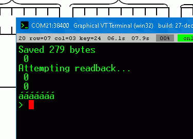

The result I get is:
So, no NACK's, but the data does not come back 1234567 as expected.

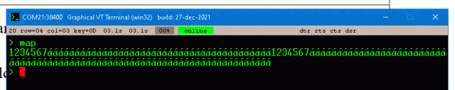

UPDATE:  Here is a result of outputting all 128 bytes from the EEPROM:
Note that there is a "1234567" towards the right of the first line - this will be where I was accidentally writing to the wrong address.  So it was working, I just didn't know it was.
