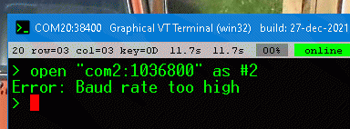

I get an expected error message:
"1036800 is invalid (valid is 24)" - is definitely an odd error message, and I suspect it is a bug of some sort.
What are you using?
170 MM2 chip?
MM+ chip?
ARMmite?
PicoMite or PicoMite VGA?
My message came from a MM2 on a 170 chip, simply as I happened to be writing something at the time I checked the forums, and everything was all hooked up, so I was able to do a quick spontaneous test.

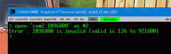

EDIT: Just tried this on a PicoMite, and I get the following error report:
So, it looks like you've maxed out the com port speed.
Edited 2022-12-13 22:35 by Grogster

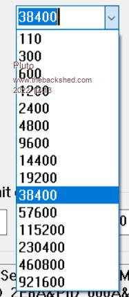

Posted: 12:44pm 13 Dec 2022
These are the standard speeds.

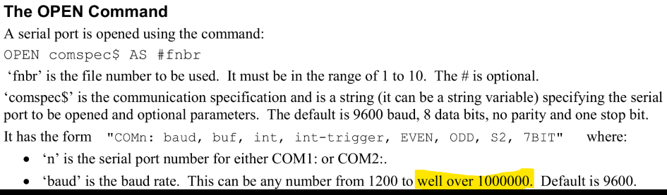

User manual: "Well over 1000000"

The "well over 1000000" thing is probably a hangover from the Micromite Plus range of devices based on the PIC32MX470 series chipset.  They have hardware UART's that were easily capable of that, but the lesser-spec chips I think could not go as fast with their UART's.  The 2040 chip used in the PicoMite I THINK has hardware UART's, but they obviously can't run QUITE as fast as the MM+ chip UART's.  In any event, 921k6 is all you're gonna get.
