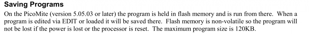

120K? Just type memory at the command prompt.

The manual states that the maximum program size is 120KB.
I take it to mean that this does NOT include the flash slots.

I still find the subject of flash slots somewhat confusing. The manual section Tinine refers to above mentions that a program is run from Flash, then goes on to mention the "main program memory" too.
