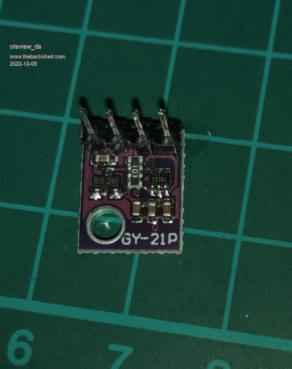

I added another slave to the I2C bus. A Temperature/Humidity Sensor, called "GP-21P".
I have it in my box from other µC projects.
2 Problems with it:
I don't have the adress and i don't know how to get any data out of it.
So, is there a command to "scan" and show the participants on the I2C bus?
And second: How do i get know wich data i have to read to get temp and/or humidity?

Could be this one. Unfortunately you did not show the other side of the board.
Atmospheric Humidity Temperature Sensor Breakout Barometric Pressure BMP280 SI7021 for Arduino GY-21P By DIY
Found on AliExpress.
Seems to be 2 sensors on the board:
Si7021 humidity sensor I2C address 0x40
BMP280 temp and pressure sensor I2C address 0x76 or 0x77
Try with these and see if you get any response.
