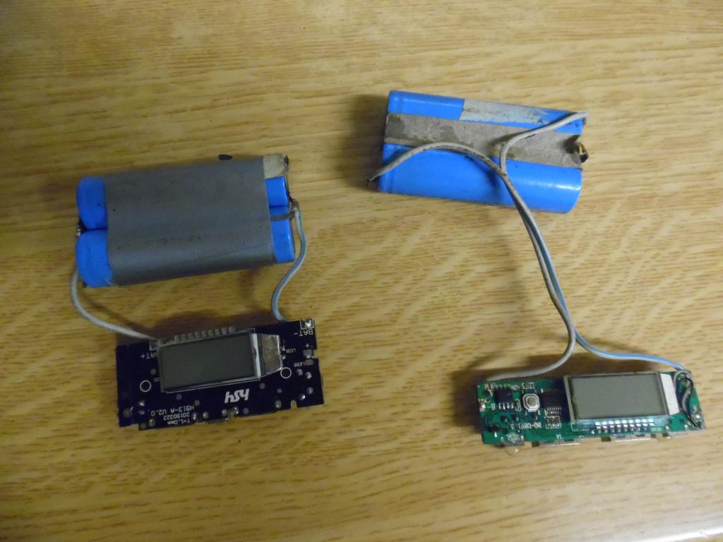

stanleyella
Joined: 25/06/2022
Posts: 2807
Posted: 07:01pm 06 Dec 2022
These are cheap. 1A and 2A usb out. Mini usb to charge and a lcd battery level
