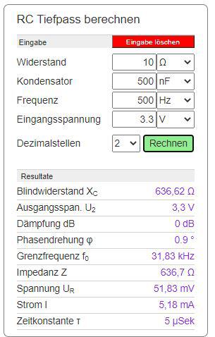

in German but I think you ll get it:
RC Low Pass
cheers

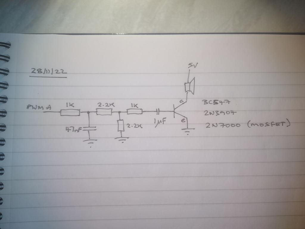

Posts: 9329
Posted: 01:07pm 28 Nov 2022
You should have a resistor/capacitor filter off the pin to get rid of the carrier frequency of the PWM. However, you might get away without them - or with just a capacitor - if driving one of the little passive sounders.
The problem is that the sounders have a truly horrible frequency response and are designed to resonate over a narrow range to get maximum beep volume. You'd be far better getting one of the small laptop speakers which, although they are still horrible, at least attempt more than one frequency.
You may need more volume than you can get from the 3V3 supply. I'd be tempted to try a simple 1-transistor output stage on the 5V rail:
               5V
             speaker
                |c
--- 1k --| |---|  NPN
         1u   |\
                V
                |e
             ---+--- GND
You should have Geoff's R/C network in front of this. You may also need a small resistor in series with the speaker if the transistor gets hot (it shouldn't). Note that this is *very* crude and can be improved a lot by adding bias resistors.
Posts: 4410
Posted: 01:32pm 28 Nov 2022
Hi folks,
Yes, I know the sound is going to be crap, but I'm hoping it is good enough for a bit of prototyping using components that I have.
@Mixtel90 if I do as you suggest verbatim then I end up with this, which I suspect is not what you mean ?
And assuming you correct my schematic will any of those transistors do the job ?
Apologies for needing spoon-feeding on this; I was learning some basic electronics but then got hijacked by the Colour Maximite about a month in.

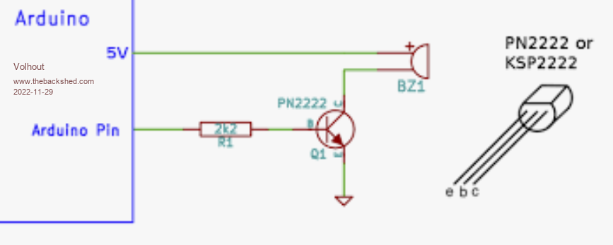

Posts: 6254
Posted: 04:10pm 28 Nov 2022
The data from the Aliexpress page looks to specify a 2700Hz buzzer operated from 2-5Vdc pulling 40mA current. So you need not drive it from a PWM. It will generate 2700Hz if you connect it to 3.3V. And it will draw 40mA.
You only need a IO pin and a FET or transistor to drive it ON and OFF.
Quick check: connect + pin to 3.3V and - pin to GND... and shiver...
Driver circuit (will work with 5V and 3.3V)
Edited 2022-11-29 02:23 by Volhout
Posts: 4410
Posted: 04:24pm 28 Nov 2022
  Volhout said  The data from the Aliexpress page looks to specify a 2700Hz buzzer operated from 2-5Vdc pulling 40mA current. So you need not drive it from a PWM. It will generate 2700Hz if you connect it to 3.3V. And it will draw 40mA.

Posts: 4410
Posted: 11:31pm 28 Nov 2022
OK, so they are active buzzers and they work fine (with PWM) using Volhout's circuit from above with the PN2222 swapped out with the BC547s that I have.
