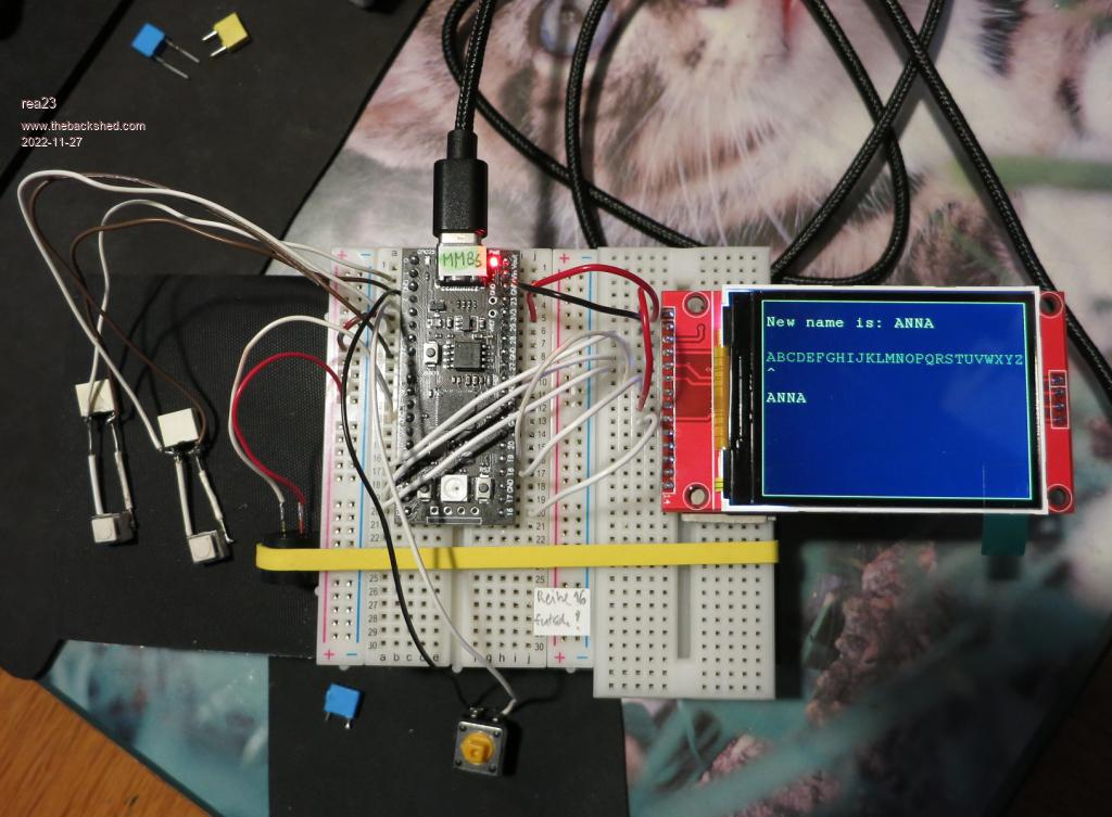

Hi
A short text, e.g. a name, is to be entered on a 2.4" display without touch screen. One possibility is shown in the listing. Maybe someone has a more elegant solution for this?
' INPUT a short text e.g. a name w/o KBD or Touch
' Use of three buttons: Left, Right and Enter
' Display 2.4", 320 x 240 ILI9341 (from MikroShop)
' works with ILI9488 driver only (Portrait mode)!
' Colors are inverted ! (255-RGB=iRGB) ?? cheap LCD
' MMBasic on Pi Pico with USB-C and on board RGB-LED!
' Test Buzzer: ok with SUB BUZZ
' 6.10.2022: Moving Cursor: two buttons < and >
' 09.11.2022: < / > button, 3rd button for Enter
' 10.11.2022: Display limit l/r ok
' Sometimes bouncing ===> 100 nF // to switches, ok
' New name: Move over margin </>, then Enter button

I've always found it frustrating trying to enter text using left & right buttons - a much quicker and friendlier method is to use a rotary encoder.  This will still need only 2 I/O pins, but it adds a little more complexity to your code.  I haven't used one personally, but you should be able to find plenty of information on the web and in this forum - indeed, there was a thread about this recently.
You could even use one that incorporates a momentary push switch as your 'enter' button - then you've got everything in one controller, and if you intend to house your circuit in a box then you'll only need to drill a single hole to mount it, rather than have to make 3 separate cut-outs for the push buttons.

Thank you for the many good ideas and the shortening of the program. I have to think about what I want to use. But the idea to use a rotary encoder is really tempting.

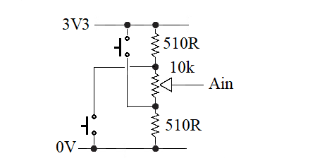

For those who have no access to a rotary encoder: you can use a analog input and measure the voltage at a potmeter connected to 3.3V and 0.
A potmeter (and knob) have enough resolution to select individual characters (1 of 26).

A potentiometer is nice idea, especially since the cursor is travelling a line of letters with stops at each end - so turn it fully left and it's at 'A', turn it fully right and it's at 'Z' - there's no wrap-around to contend with.  You'd just have to ensure that it's linear rather than logarithmic, otherwise you'd need some extra maths in the code to keep the spread of the letters equally spaced around the travel of the potentiometer!

A button can be added to the pot. input without using an extra pin.
Add resistors (about 1/10th of pot. value) between the top and bottom ends of the pot. to the rails and put the button from wiper to ground. The bottom resistor ensures voltage can only reach zero when the button is pressed. The top resistor prevents a short if the button is pressed while the wiper is at the top.
A short press enters the letter and a long one enters the name, as in the above program.
Edit
Forget that.
Two buttons can be added to the pot. input without using any extra pins. Use the second to delete the last letter.
The top button inputs 3V3 and the lower 0V while the pot goes from 0.16V to 3.14V.

Yes, TimD and phil99, it's a clever idea. And I like to turn instead of clicking.
I will do it with a potentiometer and one switch.
Many thanks

Using Peter's insight and adding provision for a second button (top one in the above diagram) to delete the last letter.
It should work as you intend with your current wiring. The extra lines should not matter.

Yes, we have to define what happens if mvolt < 220 (switch down).
But if I insert a line "IF mvolt < 220 THEN letter=letter" at the end inside the loop, the same behavior can be seen.
@phil99:
It's strange, but I get the error:
[31] Print If(mvolt > 220) And (mvolt < 3100) Then   'Read letter if no buttons pressed
Error : IF is not declared
And indeed, MM Edit or the interpreter knows nothing about a command IF or ENDIF/END IF. I don't no what happens.
Edit:
False alarm: After a restart of MM Edit the program works as intended. Thank you very much.
Edited 2022-12-04 20:47 by rea23
