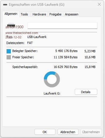

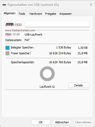

Posted: 03:11pm 01 Dec 2022
I successfully swapped the flash to a W25Q128.
What I can say is that the Mini Player behaves like a USB stick.
Windows formats the flash with FAT and then correctly shows 16 MB.
I copied a 5MB mp3 file and it works.
The copying process takes longer, since it is writing into the flash.
Next step a 25Q256 when these arrive
