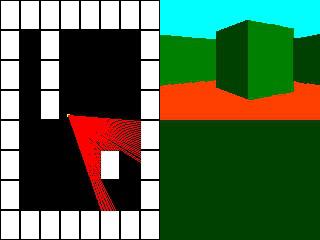

First make it work, then make it effizient
by following the YouTube Tutorial   step by step, i translated the C /openGL Code
to MM Basic and tested it on a 378000 kHz Pico Vga.
Speed on the Pico is ok but I am sure that there is much to optimise
also tested on MMBasic4W
as in the Video, there is no collition detection by now.
'Raycast.bas by Martin Herhaus
'MMBasic translation from
'https://youtu.be/gYRrGTC7GtA by 3DSage
Dim px,py,pdy,pdx,pa As float
Dim bg%,FC%,n%,mapX,mapY,mapS,HV,HH As integer
Dim Map%(84)
P2 =Pi/2
P3=3*Pi/2
DR=0.0174533 'one degree in radians
'Init
Select Case Mm.Device$
Case "PicoMiteVGA"
  Mode 2
  Font 1
  FrameBuffer Create
  FrameBuffer Write F
Case "Colour Maximite 2", "Colour Maximite 2 G2", "MMBasic for Windows"
  Mode 7
  Font 1
  Page Write 1
Case Else
  Error "Unsupported device: " + Mm.Device$
End Select
vmul=MM.VRes/512
hmul=MM.HRes/1024
hv=MM.VRes/2
hh=MM.HRes/2
Restore MapData:For n%=0 To 63:Read Map%(n%):Next n%
bg%= RGB(0,64,0)
CLS bg%
px=300:py=300:mapS=64:mapy=8:mapx=8
pdx=Cos(pa)*5:pdy=Sin(pa)*5
'main
 display
 drawRays3D
 buttons
  If Mm.Device$ = "PicoMiteVGA" Then
    FrameBuffer Copy F, N
 Else
    Page Copy 1 To 0
  EndIf
Loop
Function dist(ax,ay,bx,by,ang)
 dist=Sqr((bx-ax)*(bx-ax)+(by-ay)*(by-ay))
End Function
Sub drawRays3D
Local r,mx,my,mp,dof,xstp,wcl As Integer
Local rx,ry,ra,xo,yo,dis1 As float
ra=pa-DR*30:If ra<0 Then Inc ra,2*Pi
If ra>2*Pi Then Inc ra,-2*Pi
Box hh,0,hh,hv,,RGB(0,255,255),RGB(0,255,255)
Box hh,hv/2,hh,hv/2,,RGB(255,64,0),RGB(255,64,0)
For r=0 To 59
'check Horizontal Lines
dof=0
distH=1000000:hx=px:hy=py
atan=-1/Tan(ra)
If ra>Pi Then
  ry=((Int(py/64))*64)-0.0001:rx=(py-ry)*atan+px ' Looking up
  yo=-64:xo=-yo*atan
EndIf
If ra<Pi Then
  ry=((Int(py/64))*64)+64:rx=(py-ry)*atan+px ' Looking down
  yo=64:xo=-yo*atan
EndIf
 If ra=0 Or ra=Pi Then rx=px:ry=py:dof=8 'looking straight left or right
 Do While dof<8
 mx=Int(rx/64):my=Int(ry/64):mp=my*mapx+mx
 If mp>0 And mp<mapX*mapY Then If map%(mp)=1 Then
  hx=rx:hy=ry:distH=dist(px,py,hx,hy,ra):dof=8
  Else
   rx=rx+Xo:ry=ry+Yo:Inc dof
  EndIf
 Loop
 'Line px*hmul,py*vmul,rx*hmul,ry*vmul,,RGB(Green)
'check vertical Lines
dof=0
 distV=1000000:vx=px:vy=py
ntan=-Tan(ra)
If ra>P2 And ra< P3 Then
  rx=((Int(px/64))*64)-0.0001:ry=(px-rx)*ntan+py ' Looking left
  xo=-64:yo=-xo*ntan
EndIf
If ra<P2 Or ra > P3 Then
  rx=((Int(px/64))*64)+64:ry=(px-rx)*ntan+py ' Looking right
  xo=64:yo=-xo*ntan
EndIf
 If ra=0 Or ra=Pi Then rx=px:ry=py:dof=8 'looking straight up or down
 Do While dof<8
 If mp<(mapX*mapY)And mp>-1 Then If map%(mp)=1 Then
  vx=rx:vy=ry:distV=dist(px,py,vx,vy,ra):dof=8
  Else
  EndIf
 Loop
 If distV<distH Then rx=vx:ry=vy:dis1=DistV:wcl=RGB(0,128,0)
 If distH<distV Then rx=hx:ry=hy:dis1=DistH:wcl=RGB(0,64,0)
 Line px*hmul,py*vmul,rx*hmul,ry*vmul,,RGB(RED)
 '--- Draw 3D Walls
 ca=pa-ra
 If ca<0 Then Inc ca,2*Pi
 If ca>2*Pi Then Inc ca,-2*Pi
 dis1=dis1*Cos(ca)
 lineH=int((mapS*hh)/dis1):If lineH>hv Then lineh=hv
 lineO=int(lineh/2)
 Box hh+xstp,(hv/2)-LineO,hh/60,Lineh,,wcl,wcl
 Inc xstp,hh/60
 Inc ra,dr:If ra<0 Then Inc ra,2*Pi
Next
End Sub
Sub display
drawmap2d
drawPlayer
End Sub
Sub drawPlayer
 Local xo,yo
 xo=px*hmul:yo=py*vmul
 fc%=RGB(yellow)
 Box xo-1,yo-1,3,3,,fc%
 Line xo,yo,xo+pdx*5*hmul,yo+pdy*5*vmul,,fc%
End Sub
Sub buttons
Local k$
k$=Inkey$
Select Case k$
 Case "a",Chr$(130)
   Inc pa,-0.1
   If pa<0 Then Inc pa,2*Pi
 Case "d",Chr$(131)
   Inc pa, 0.1
   If pa>2*Pi Then Inc pa,-2*Pi
 Case "w",Chr$(128):px=px+pdx:py=py+pdy
 Case "s",Chr$(129):px=px-pdx:py=py-pdy
 Case " ": Save image "cast.bmp"
End Select
End Sub
Sub drawMap2D
Local x,y,xo,yo As integer
xo=64*hmul:yo=64*vmul
For y=0 To mapy-1:For x=0 To mapx-1
    Box x*xo,y*yo,xo,yo,,0,RGB(white)*(map%(y*mapX+x)=1)
  Next : Next
End Sub
MapData:
Data 1,1,1,1,1,1,1,1
Data 1,0,1,0,0,0,0,1
Data 1,0,0,0,0,0,0,1
Data 1,0,0,0,0,1,0,1

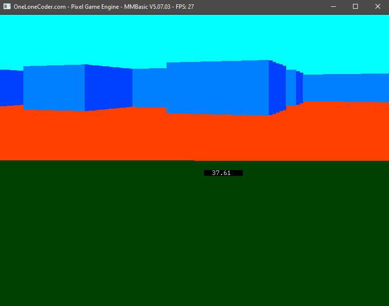

updated Version
(here in Windows)
'Raycast Engine MMBasic translated from
Dim float px,py,pdy,pdx,pa
Dim integer fps%,bg%,FC%,n%,mapX,mapY,mapS,HV,HH,vmul,hnul
mapS=64:mapy=24:mapx=24
Dim Map%(mapy*mapx)
P2 =Pi/2
P3=3*Pi/2
P2I=2*PI
'Init
Case "PicoMiteVGA"
 Mode 2
 Font 1
 FrameBuffer Create
 FrameBuffer Write F
 Mode 1,8 '800x600
 Font 1
 Page Write 1
Case Else
End Select
vmul=MM.VRes/512
hmul=MM.HRes/1024
hv=MM.VRes/2
hh=MM.HRes/2
Restore MapData:For n%=0 To mapx*mapy-1:Read Map%(n%):Next n%
bg%= RGB(0,64,0)
CLS bg%
px=300:py=300
tm%=Timer:fps%=0
'main
' display
drawRays3D
buttons
Else
   Page Copy 1 To 0
 EndIf
inc fps%:
if fps%=500 then
tm%=timer-tm%
  text hh+20,hv+20,str$(500/(tm%/1000),4,2)+"   ":fps%=0:tm%=Timer
end if
Loop
End Function
Sub drawRays3D
 Local integer r,mx,my,mp,dof,xstp,wcl
 Local float rx,ry,ra,xo,yo,dis1
 ra=pa-DR*30:Inc ra,P2i*(ra<0):Inc ra,-P2I*(ra>P2I)
 Box 0,0,hh<<1,hv,,RGB(0,255,255),RGB(0,255,255)
 Box 0,hv/2,hh<<1,hv/2,,RGB(255,64,0),RGB(255,64,0)
 'Cast 120 Rays
 For r=0 To 119
     dof=0
     atan=-1/Tan(ra)
     If ra>Pi Then
       ry=((Int(py>>6))<<6)-0.0001:rx=(py-ry)*atan+px ' Looking up
       yo=-64:xo=-yo*atan
     else
       ry=((Int(py>>6))<<6)+64:rx=(py-ry)*atan+px ' Looking down
       yo=64:xo=-yo*atan
     EndIf
     If not ra Or ra=Pi Then rx=px:ry=py:dof=mapx 'looking straight left or right
     Do While dof<mapx
       mx=Int(rx)>>6:my=Int(ry)>>6:mp=my*mapx+mx
         If mp>0 And mp<mapX*mapY Then If map%(mp)<>0 Then
           hx=rx:hy=ry:distH=dist(px,py,hx,hy,ra):dof=mapx
         Else
           inc rx,Xo:inc ry,Yo:Inc dof
        End If
    Loop
   dof=0
   ntan=-Tan(ra)
     rx=((Int(px>>6))<<6)-0.0001:ry=(px-rx)*ntan+py ' Looking left
     xo=-64:yo=-xo*ntan
   else
     rx=((Int(px>>6))<<6)+64:ry=(px-rx)*ntan+py ' Looking right
     xo=64:yo=-xo*ntan
   End If
    If not ra Or ra=Pi Then rx=px:ry=py:dof=mapy 'looking straight up or down
    Do While dof<mapy
      If mp<(mapX*mapY)And mp>-1 Then If map%(mp)<>0 Then
        vx=rx:vy=ry:distV=dist(px,py,vx,vy,ra):dof=mapy
      Else
     End If
    Loop
    If distH<distV Then
      rx=hx:ry=hy:dis1=DistH:wcl=RGB(0,64,255)
    else
      rx=vx:ry=vy:dis1=DistV:wcl=RGB(0,128,255)
    end if
   '--- Draw 3D Walls
    ca=pa-ra:Inc ca,P2I*(ca<0):Inc ca,-P2I*(ca>P2I)
    dis1=dis1*Cos(ca)
    lineH=int((mapS*hh)/dis1):lineH=Min(lineH,hv)
    lineO=int(lineh>>1)
    Box xstp,(hv>>1)-LineO,1+hh/60,Lineh,,wcl,wcl
    Inc xstp,hh/60
    Inc ra,dr/2:Inc ra,P2I*(Ra<0):Inc ra,-P2I*(ra>P2I)
Next
End Sub
Sub display
drawmap2d
drawPlayer
End Sub
Sub drawPlayer
'unused
Local xo,yo
fc%=RGB(yellow)
End Sub
Sub buttons
Local k$
k$=Inkey$
Select Case k$
Case "a",Chr$(130)
  Inc pa,-0.1
  If pa<0 Then Inc pa,P2I
Case "d",Chr$(131)
  Inc pa, 0.1
  If pa>P2I Then Inc pa,-P2I
Case "w",Chr$(128):inc px,2*pdx:inc py,2*pdy
Case "s",Chr$(129):inc px,2*-pdx:inc py,2*-pdy
End Select
End Sub
Sub drawMap2D
'unused
Local integer x,y,xo,yo
YO=2*HV/mapy:xo=HH/mapx
xo=xo*hmul:yo=yo*vmul
   Box x*xo,y*yo,xo,yo,,0,RGB(white)*(map%(y*mapX+x)<>0)
 Next : Next
End Sub
MapData:
Data 1,1,1,1,1,1,1,1,1,1,1,1,1,1,1,1,1,1,1,1,1,1,1,1
Data 1,0,0,0,0,0,0,0,0,0,0,0,0,0,0,0,1,0,0,0,0,0,0,1
Data 1,0,1,0,0,0,0,0,0,0,0,0,0,0,0,0,0,0,0,0,0,0,0,1
Data 1,0,1,0,0,0,0,0,0,0,0,0,0,0,0,0,1,0,0,0,0,0,0,1
Data 1,0,1,0,0,0,0,1,1,1,1,1,1,1,1,1,1,1,0,1,1,1,1,1
Data 1,0,1,0,0,0,0,1,0,1,0,1,0,1,0,1,1,0,0,0,1,1,1,1
Data 1,0,1,0,0,0,0,1,0,0,0,0,0,0,0,1,1,0,0,0,0,0,0,8
Data 1,0,1,0,0,0,0,0,0,0,0,0,0,0,0,0,0,0,0,0,1,1,1,1
Data 1,0,1,0,0,0,0,1,0,0,0,0,0,0,0,1,1,0,0,0,0,0,0,1
Data 1,0,0,0,0,0,0,1,0,0,0,0,0,0,0,1,1,0,0,0,1,1,1,1
Data 1,0,0,0,0,0,0,1,1,1,1,0,1,1,1,1,1,1,1,1,1,1,1,1
Data 1,1,1,1,1,1,1,1,1,1,1,0,1,1,1,1,1,1,1,1,1,1,1,1
Data 1,0,0,0,0,0,0,0,0,0,0,0,0,0,0,0,0,0,0,0,0,0,0,1
Data 1,1,1,1,1,1,0,1,1,1,1,0,1,1,1,1,1,1,1,1,1,1,1,1
Data 1,0,0,0,0,0,0,0,0,1,1,0,1,1,0,0,0,0,0,1,0,0,0,1
Data 1,0,0,0,0,0,0,0,0,0,0,0,1,1,0,0,1,0,0,1,0,0,0,1
Data 1,0,0,0,0,0,0,0,0,1,1,0,1,1,0,0,0,0,0,1,1,0,1,1
Data 1,0,1,0,1,0,0,0,0,1,1,0,0,0,0,0,1,0,0,0,0,0,0,1
Data 1,0,0,1,0,0,0,0,0,1,1,0,1,1,0,0,0,0,0,1,1,0,1,1
Data 1,0,1,0,1,0,0,0,0,1,1,0,1,1,0,0,1,0,0,1,0,0,0,1

Very nice Martin, a bit slow on the poor old PicoMite but nothing a bout of optimisation, or failing that, a CSUB wouldn't fix I'm sure.
I have once again taken the liberty to use your code to continue ironing out some issues with my controller library:
CMM2 version with support for Wii Nunchuk, Classic, and on the DX version Atari joystick and NES gamepad; note that the latter requires an adapter to cross-over the power pin:
       raycast-cmm2.zip
PicoMiteVGA version with support for Atari joystick and NES gamepad using the PicoGAME Port A pins:
       raycast-pmvga.zip
Edited 2022-11-23 23:37 by thwill

sadly, I haven't found any instructions on the web yet how to compile CSubs for the Pico (Environment, compiler etc).
But maybe, I Find a faster Algorhitm to do the casts in Basic.
On the Website, where the BubbleDemo came from, is a Algorhytm with a different approach.
For Now, you'll get it a little faster by lowering the resolution
change in the  drawRays3D sub
than it does less Scans per Frame
For r=0 To 119
to
For r=0 To 63
and  the Part
Inc xstp,hh/60
to
Box xstp,(hv>>1)-LineO,1+hh/32,Lineh,,wcl,wcl
Inc xstp,hh/32
PS: Your Version works well, as long as I use Port A for Atari or NES Controller
Edited 2022-11-24 00:41 by Martin H.

in my working Version I didn't use the Distance Function anymore, cause every Function call is timeconsuming .. So i do the pythagoras calculation within the Program, two times
Also, to speed things up I try to use "IF THEN" in the Loop only if it is really necessary.
That's why some adventurous lines come out like :
Inc ra,P2I*(Ra<0)-P2I*(ra>P2I)
to keep it in the Range of 2 Pi
Another way to optimize would be to rewrite the Algorythm to use degrees instead of radius, so I can convert the "floating Point Calculations" to Integers.
the best CSub would have to contain the whole Raycast Function like
Cast PX,PY,PA,Casts
that returnes the "casts" number of distances in an Array which can be read in the Draw_Wall Sub. :-)
As you can see, there is still a lot to optimize.
I have to go to the office now, but I'll think of something.
Cheers,
Mart!n
Edited 2022-11-24 16:25 by Martin H.
