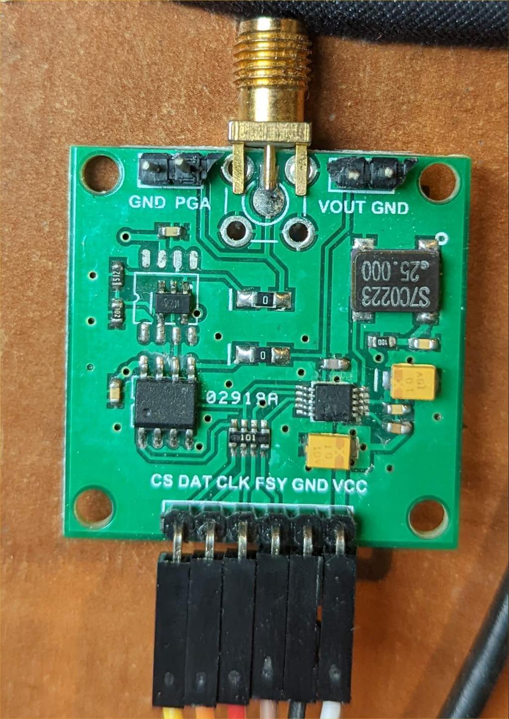

To make this work you need one of these AD9833 modules. It must be this version which has a variable gain output stage.

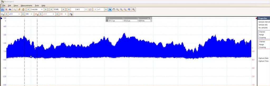

The Basic code is very simple. It sets the signal generator to a fixed frequency sine wave (891KHz is unused in the UK) by bitbanging the SPI bus. It then calls the Cfunction which replaces the normal PWM output from the audio interrupt routine with itself. This means that each interrupt (normally 44.1KHz) the CSUB function "audio" is called and it changes the amplitude of the sinewave carrier to create the AM signal.
There are two modes of operation. If the optional analogue input pin is specified in the call to the CSUB then the pin is sampled each interrupt and the amplitude adjusted accordingly. If the analogue pin is omitted in the call to the CSUB then whatever is output using the play command will be used to modify the amplitude (WAV files, TONES, SOUNDS).
Notes: the PicoMite must be set to run at 378MHz for this to work (OPTION CPUSPEED 378000). The AD9833 module should be powered with 5V not 3.3V. Because the ARM M0 core does not include an integer divide the compiler calls a function to do this. This means you can't use the / symbol in a CSUB unless it optimises to a shift (/2 etc.). I have added a callable routine IDiv to the firmware to get round this.
The output of the AD9833 is of course single ended so the waveform looks a bit odd but the radio picks it up fine with a short wire connected to the PGA pin. This is a 50 ohm output and I'm sure the "analogue" experts can suggest a suitable circuit to improve this.

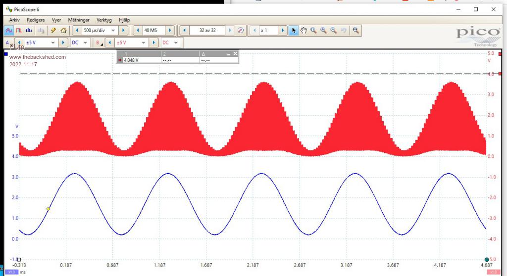

The module outputs the carrier wave exactly at the correct frequency. I have a signal generator (a la Geoff) connected to the analog input pin 34 (ADC2).
The problem is that I am not able to get any modulation on the carrier wave.
> option list
PicoMiteVGA MMBasic Version 5.07.05RC9
OPTION FLASH SIZE 4194304
OPTION KEYBOARD US
OPTION CPUSPEED (KHz) 378000
Are there any more option that I should install?
I do not have a SD card connected as I intended to test with just analog input.
Tested also with ADC0 and ADC1. No difference. No modulation.

Try just connecting pin 34 to 3.3V and then to GND you should see the modulation changing. If not check pin 34 is working as a simple analogue input.
UPDATE
Just noticed you haven't got OPTION AUDIO set. This is needed to create the interrupts. You can also test by replacing PLAY WAV "" with for example PLAY TONE 400,400

Added OPTION AUDIO GP26,GP27 and a SD-card with a wav-file. I thought that OPTION AUDIO was only required for audio output.
Works now and I have just started my own broadcasting company. Hmm... it is closer to Narrowcasting. Just and just hearable inside the house.
Works now also with analog input.
This became a very nice toy to play with!
Stay tuned on 891kHz...maybe you can hear my 1000Hz signal.
