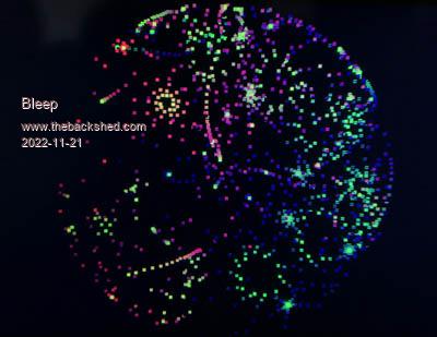

Hi,
I've optimised this code for a LCD display, it now runs at approx 2Hz on a Pico running at 378MHz. I've reduced the number of plotted pixels, each pixel is drawn, then at the next iteration un_drawn, rather than doing a complete screen clear, I've also made them larger, to be more visible on a small screen, it's still managing to display about 1700 point per screen update.
Bubble video
Unfortunately it does make the code more unreadable. :-(

Posts: 6254
Posted: 12:56pm 21 Nov 2022
Hi Bleep,
Why are you calculating the f() and l() coordinates ? Could you copy them from c() and d() ? Using MATH ADD c(),0,f()
Bleep
Joined: 09/01/2022
Posts: 877
Posted: 02:34pm 21 Nov 2022
Hi Volhout,
You could, but you would then only get 41 pixels at any one time. Currently it calculates 41x41 (i&j) in the for loops, which then progressively update 41 pixels at a time. I did look at saving all the points in an array, but the array used to much memory, because all variables use 64bits only, I also looked at saving 2 or 4 smaller integers in each array element by masking & shifting, but even then the array was too big, though that was before I reduced the number of pixels displayed, so may now be possible, but may not gain a huge amount, because of the slowness of the serial data transfer to the display.
Regards Kevin.

Hi Volhout,
Here you go, it is very fractionally faster, but still basically 2Hz update, however the two arrays use up 28kB of memory, in theory the update should be smoother as it now updates a pixel at a time.
