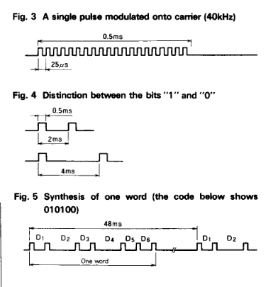

I have a 40kHz IR receiver (plus a couple of 38kHz) on order to see if I can read out the codes sent by the working remote.  If I cant get this via the PicoMite/IR I will fire up my oscilloscope to see if I can capture the signal  / bit pattern directly.
According to the data sheet, the IC uses a 40kHz carrier -- and 6 bit command words.
I think I should be OK to read / decode the existing remote.  But the PicoMite manual talks about 38kHz / 12bit for sending IR.
Ok, so the built in "sending" doesn't look like it would work -- so time to roll my own. The datasheet talks about 2msec and 4msec intervals being a "0" and "1"  -- so question:  Can I modulate an IR diode fast enough to make "0" and "1", with each pulse being 25us << that's the big question I suppose.

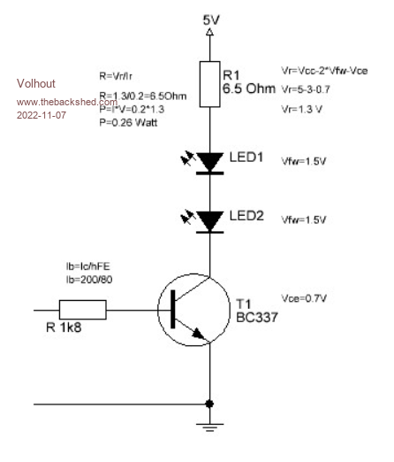

an IR driving circuit can be as this one:
EDIT: documentation is a bit vague on "0" and "1" bit times. I thinki I got it correct in above code now.
Edited 2022-11-07 20:23 by Volhout

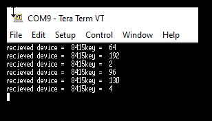

News:  The standard IR decoding circuit doesn't detect / read the remote (not surprising).  I did check that the circuit worked with another remote - an LG TV.

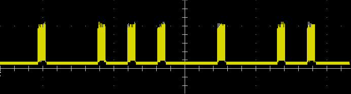

So the next thing was to dig up the 'scope:
From this, the measured frequency of the carrier is 38kHz (as expected)
The pulse shown is 100110 - which from the "1" button (if I remember correctly).  It looks like each pulse is sent word is sent multiple times  -- but from reading the manual, it appears that the device only responds to one pulse regardless of how long you hold the button.  The device then "beeps" to say it is read for the next input.
I need to investigate that more, but it looks like I can now capture the words/bits for the remote and then build upon the code here to make a custom remote.
More updates to follow.

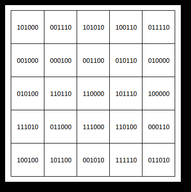

I've decoded the matrix  (I think I just wanted to post those words!!!)...
Once I set my scope up properly and soldered some temp wires to the remote control, this was quite easy - especially as there is no protocol to speak of -- press the button and the same code gets sent repeatedly until you release the button.
So, now to build a simple transmitter.
