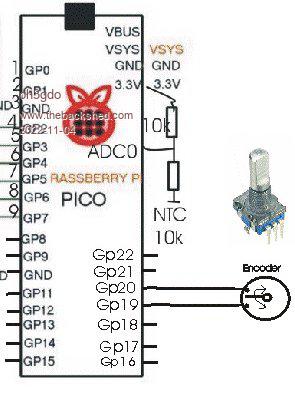

Hey, I have again a new problem.
Now with Encoder.
I did nor get pin 19 and pin 20 to go 3.3V
I added 10k resistors from both to 3.3V.
Now I got 3.3V, but it doesn't start the Inter sub program, when I connect Encoder signals to ground.
Can somebody help me?

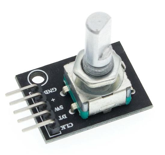

Is that a rotary encoder or a potentiometer? The rotary encoder modules I've used have had 5 pins.

I have only two contact to ground. one to left the other to right.
I have got it worked in CCS c-language, but now I do not get the pins to ground,
although my multi meter shows ground.

Posts: 6607
Posted: 08:22pm 03 Nov 2022
PIN 19 is not the same as pin GP19
You can use the physical pin numbers (pin 25 and 26) or GP19 and GP20
If you have external pullups, you don't need the PULLUP option but that shouldn't matter.

These are the rotary encoder modules I have used, which work perfectly with Peter's code.

IIRC, lizby, those have pull-ups to + from clk, dat & Sw. All three are then pulled down when active. It's a simple wiper-type encoder, not optical. It's easy to check - an active encoder will have both VCC and GND to the encoder itself, as well as anything else. These are actually 4-wires: clk, dat, sw & common.

I checked my circuit and found that I have once mode put my wires one down.
When corrected the numbers right PIN 18 and PIN 19, the circuit works find!
Thank you.
