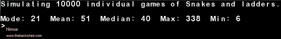

In the board designed below - interesting to see the range of rolls.
edit:  edited to return the index of the bin (ie roll value - and not just the count)

roll_mean = math(mean rolls())
roll_median = math(median rolls())
roll_max = math(max rolls())
roll_min = math(min rolls())
sort bins(), binindex()
roll_modal =  binindex(500)
print""
print "Mode:"roll_modal, "Mean:" roll_mean, "Median:" roll_median, "Max:" roll_max, "Min:" roll_min

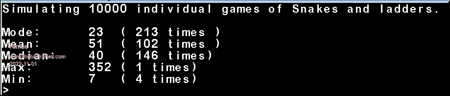

Hi Nimue,
I guess you are running this on a CMM2, since my picomite cannot run your simulation.
I guess youd DIM rolls(maxit) simply asks too much memory for the small picomite.
By creating 2 arrays ( bins() and binindex() ) you may be overcomplicating the algorythm.
I use this (based on the first post snakes and ladders program).
option base 1
dim board(100)      'the 100 squares of the board
dim bins(500)       'gather statistics of the runs (is zero'ed at creation)
' Snakes and Ladders simulation
' Pre populate board with squares that equal its number
for x = 1 to 100
let board(x) = x
next x
' load in structure of snakes and ladders from DATA statements
for y = 1 to 18
read start, finish
let board(start) = finish
next y
'reset rolls and set number of simulations
let roll_total = 0
let maxit = 10000 '10,000 gives a consistent overall average
print "Simulating"maxit " individual games of Snakes and ladders."
'set up the simulation
for runs = 1 to maxit
let position = 1
let rolls = 0
do  'individual games
  roll = int((rnd*5)+0.5)+1
  position = position + roll
  if position >= 100 then exit do
  position = board(position)
  rolls = rolls + 1
loop while position <100
roll_total = roll_total+rolls
bins(rolls)=bins(rolls)+1
next runs
print "Overall average after" maxit " rolls is" int((roll_total/maxit)+0.5) " rolls"
' calculate modal% value (the index in the array) and qty (the number of times it is ' rolled.
qty=math(max bins(),modal%)
print "modal value = ";modal%;" occurring ";qty;" times"
'ladders and then snakes
data 5,23,7,55,13,31,20,39,33,69,37,86,57,83,61,99,71,92
data 45,9,47,11,63,43,74,49,77,51,81,26,88,3,94,53,96,41
Please note that the MATH(MAX ...) command allows you to read the max value, but also the index at which this max value occurs. So in one command you have the index, and the value....

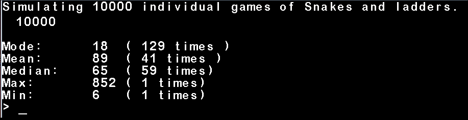

Nimue
Joined: 06/08/2020
Posts: 449
Posted: 01:57pm 01 Nov 2022
Not all boards are the same...
I imagine that 800+ rolls games would end with me tipping the board over
