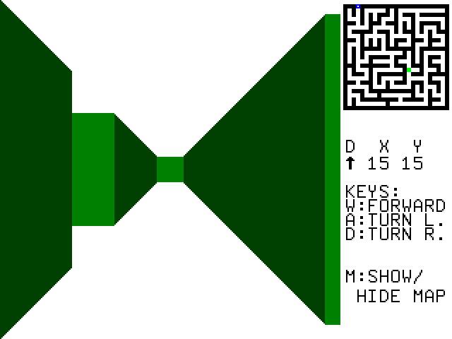

PicoMite 3D Maze
My little weekend project
also for ILI9341 LCDPANEL
all thats missing is the Monster

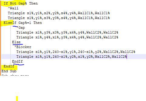

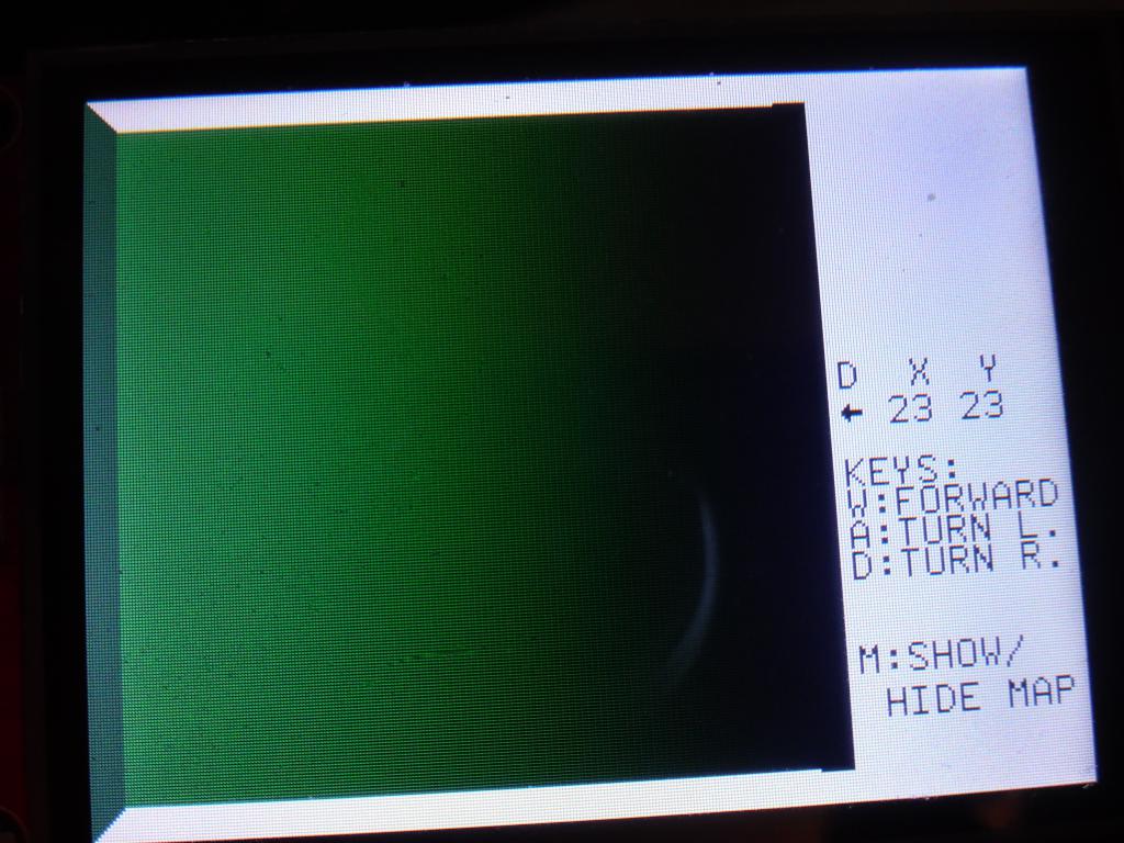

  stanleyella said  I have not tried to code this but it looks very good from your pictures.
I would have thought filled triangles slow but maybe filled boxes, circles
are optimised functions.
nice job... remember comment everything to share.
I tested it also on an ILI9341 LCD.
The only drawback is that the image of the labyrinth is a little to  small for my old eyes on the 2.8 inch display
this makes it hard to see the little green dot.
Since the walls on the sides are trapezoidal,
I can't use the box function
(x1,Y1) ......
       |          ....(X3,Y3)
       |          ....(X4,Y4)
(X2,Y2) ......
I draw one triagngle connecting the Corners 1->3->4->1
                   and the second triangle 1->2->4->1
As
I used the same for the Gaps and the Wall in Front
because the parameters of the BOX command are different (X,Y,W,H).
I didn't feel like converting the coordinates again  and the
triagngle command is fast enough.
This isn't animation in the proper sense, so the refresh rate doesn't really matter.

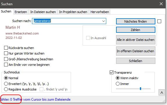

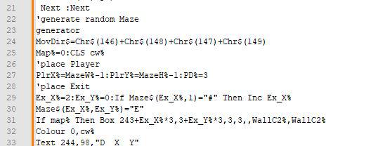

Martin H.
Joined: 04/06/2022
Posts: 1579
Posted: 06:31pm 01 Nov 2022
  stanleyella said  I get
RUN
[26] generatorcc
Error : Unknown command
there is no generatorcc in the Code abov.
Maybee you had some errors while Copy&Paste it or something you 've changed?
Line 23 (Not 26) calls the Sub, named generator
but no"cc" in there..
so, I have no idea what went wrong
Edited 2022-11-02 04:47 by Martin H.
'no comment

I did find an extra Endif in the Draw_Element sub. Not causing a problem because it is at the end of the sub.
Hi Jim,
Good extension to add the Cursor Keys, I will add that
the first Endif  belongs to the Else if statement,
The second belongs to the enclosing IF query
but there is no particular reason why I solved it that way.

  Martin H. said  the first Endif  belongs to the Else if statement,
It looks like the code has
ElseIf
where it should be
Else If
Or, drop an EndIf

Posted: 08:50am 02 Nov 2022
ElseIf
where it should be
Else If
ELSE IF and ELSEIF are interchangeable in MMBasic
you would need separate lines:
ELSE
IF
for Martins extra ENDIF to be functional.
