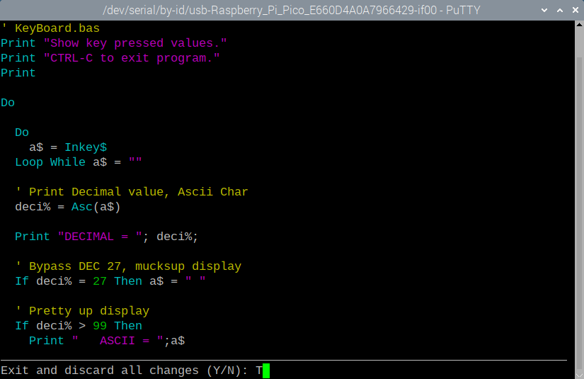

I installed the 5.07.05 stable uf2 file on my raspberry pi pico and I seem to have an issue when I use the F4 Mark then then with the arrow mark the text. I then use F5 Copy. The high lite area turns normal and the editor shows the standard menu items at the bottom. I move move the cursor to the new position and press F5 Paste, but then throws me out of the editor and displays "> T".
What gets me is something has changed in the behavior as days ago when pressing F5 to Paste a message at the bottom of the editor something like "Do you wish to cancel or discard changes Y/N > T" but I don't seem to be able to make that happen again! N cancels whatever that was and returns me to normal editing.
Really baffled on how to use this feature and why it changed.

PS:
I tried new at the command line, typed some stuff and went through the F4,F5,F5 sequence and got the editor to correctly show the original problem.
At the bottom of the editor it says "Exit and discard all (Y/N): T".
"Y" kicks you out of the editor removing ANY changes made before saving. "N" resumes normal editing and shows nothing got pasted.

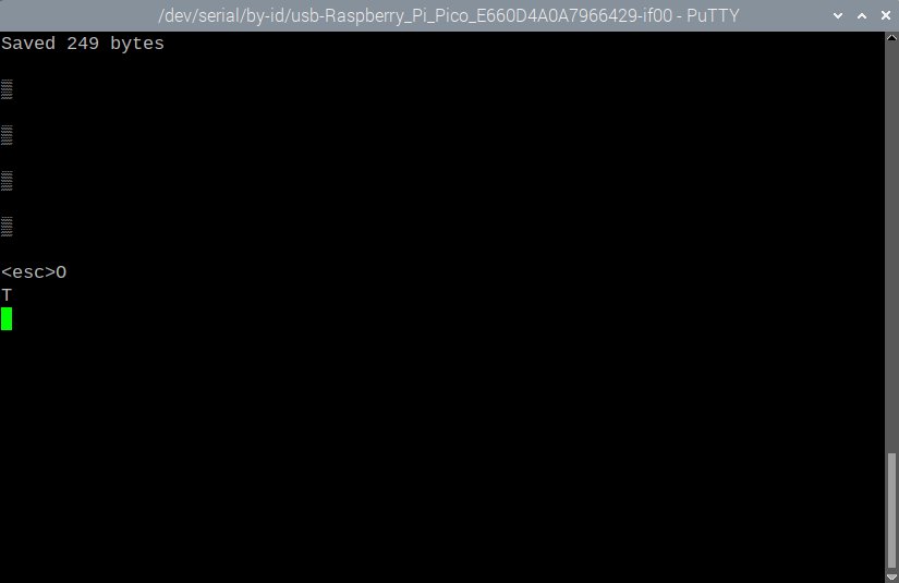

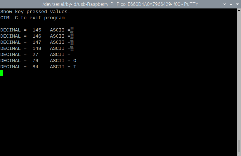

That being said I wrote my own program to capture key presses. My program is similar but it shows the decimal and ASCII characters. Every F key 5 and up to F12 shows the program receiving 3 values with the one key press. The screen shot below was from F1, F2, F3, F4, F5, and behold the mysterious "T" shows up as the last character of 3 from F5. I didn't think KBs did that on F keys.
So Whats happening? I will be trying some other languages to see if this behavior continues. I will try your program as well to see if the results are any different but F5 and beyond all throw an ESC key as the 1st piece of data, which explains the discard message, and the "T" in the input area.
This capture shows the message after F5 is pressed.

This is the suggested program capture, F1 to F5.

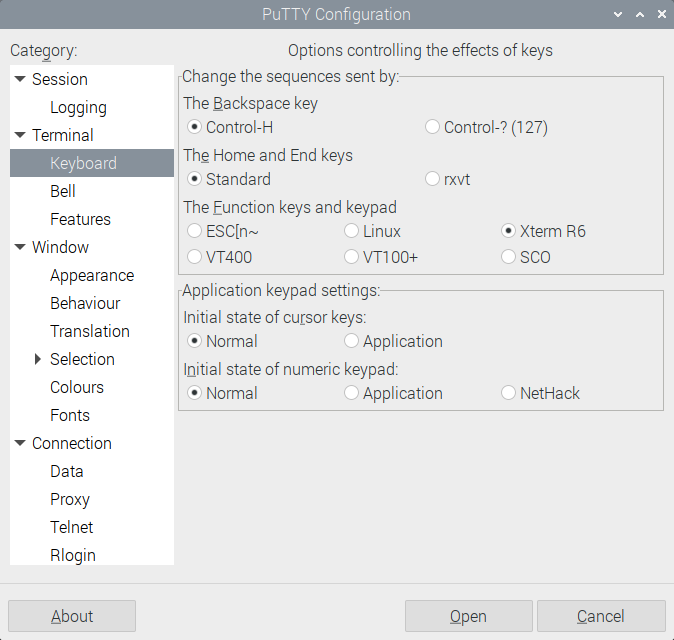

Terminals send an escape string for the function keys
The pico internally translates them into the high values you are seeing
Example
For F3 a terminal will send <esc>[13~ and mmbasic will report it as chr$(147)
The bad news is, there are lots of 'standards' XTERM and VT100 etc and what sequence they send varies, especially the shifted function keys.
Some of the function keys are also reserved for the terminal program and will not get sent.
Your terminal setting are sending a sequence that is not recognized by MMBasic.
If the RPi version of Putty allows it, you could try a different function key encoding.
Rob's GFXterm or my MMEdit should both work correctly on the RPi.

Robert talked about GFXterm so I looked at the putty settings and there is a Function Keys and Pad setting  option to Xterm R6 so I changed it to that from VT100+. The F5 works properly as far as the quick test that I tried.
I should have remembered that the terminal you emulate makes the behavior different.
