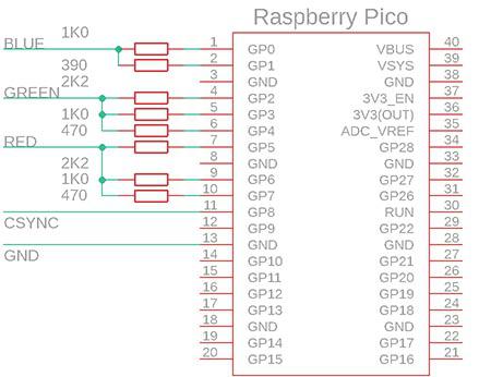

IIRC the python VGA system is expecting 3 pins per colour plus the syncs. That's 11 pins used. For your idea to work you are going to have to reserve 13 pins (including PS/2 keyboard). The resistor values almost certainly won't be compatible (and you will be mixing the outputs on RGB pins), so you will probably have to reserve a further 4 pins for the PicoMite VGA. 17 pins for just the display and keyboard isn't great.
An alternative way would be to have a pcb with 2 Picos on, one wired for the python library and the other for the Picomite VGA. I've no idea what MCUME uses.

No Mick now that you explain it, it's not going to work the Python Library is expecting this circuit
I knew I was going to spend a lot of pins on VGA and Keyboard, But I was hoping to make it with 2 picos maybe like the Pico Pair, which is giving me fits right now :( but I do have another Picomite Experimenter system in mind :)

The VGA version of the picomite uses many of the pico's GPIO pins (14 of the 24 when you use all options SD/RTC/PS2/audio/VGA) leaving only 10 to play with. I will for some of my projects add I2C IO to expand the IO of the picomite VGA. Probably one or 2 PCF8574's or PCF9574's
But the free GPIO's on the VGA picomite are grouped nicely
- GP0..GP5 with digital functions, this is a nice group for PIO-1 experiments
- GP22 and GP26/27/28 (one digital and the 3 analog pins) is a second group.
So a layout looks still simple.
Moving pins around may be possible with all but the VGA pins.
The VGA pins most likely must be 6 successive pins, since the PIO is designed to work with groups of pins, not so much with individual pins.
That is why it is good you realize that the python VGA output uses 8 successive pins for RGB, and that can most likely NOT be mapped onto the picomite VGA pins, or you must redesign the PIO VGA code, and loose access to the remaining 4 pins. Are you sure the python circuit is VGA ? VGA uses HSYNC and VSYNC, not CSYNC. anyway..
