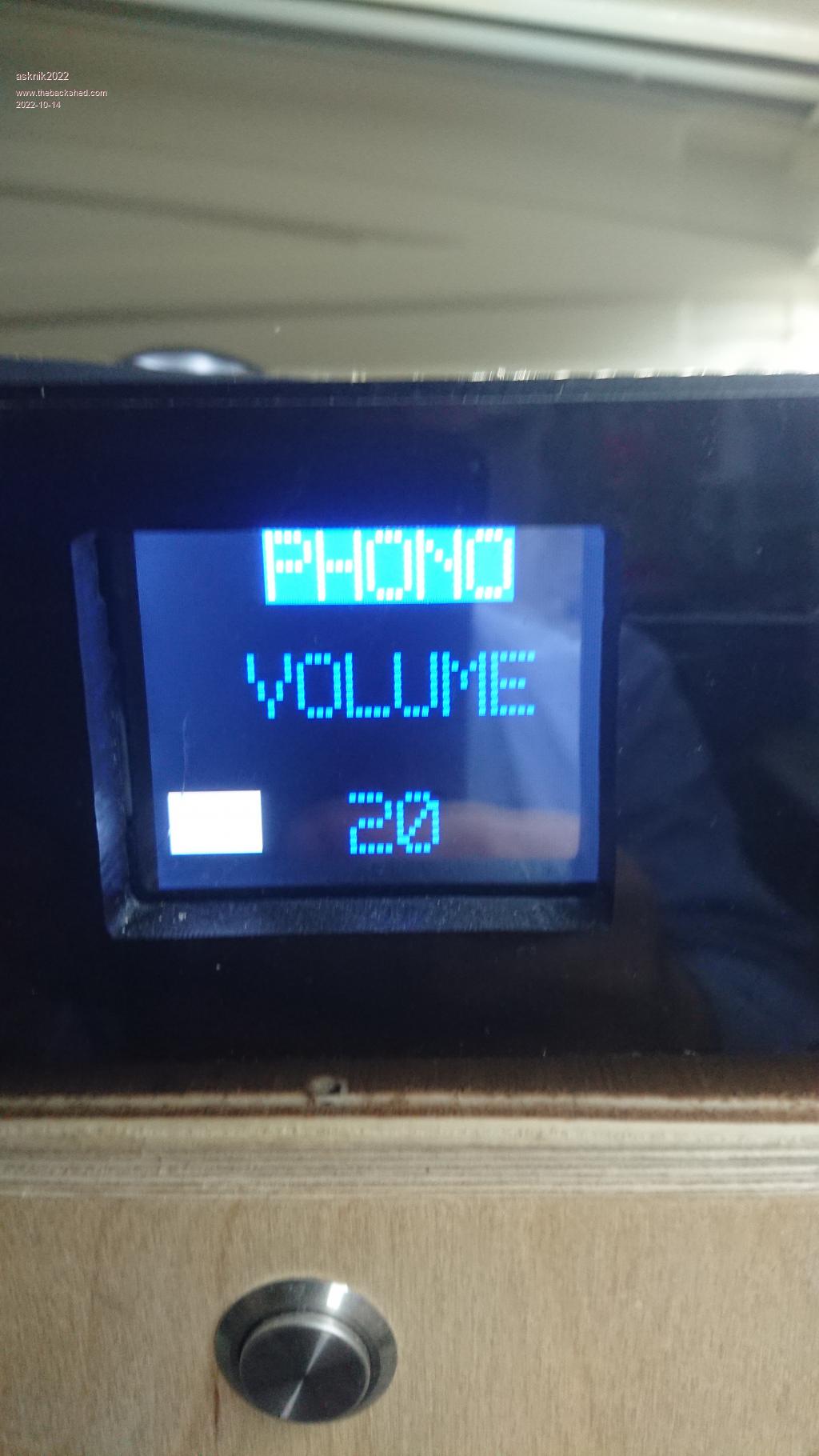

Is anybody interested in the above as I have built one and would love to share etc..

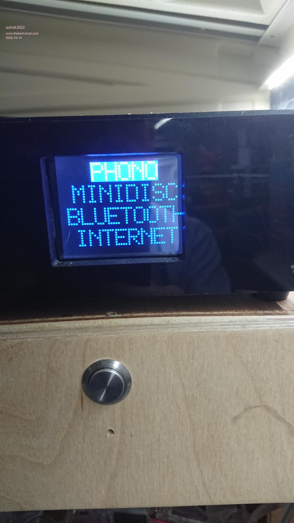

asknik2022
Joined: 26/03/2022
Posts: 94
Posted: 04:54pm 13 Oct 2022
Edited 2022-10-14 02:56 by asknik2022

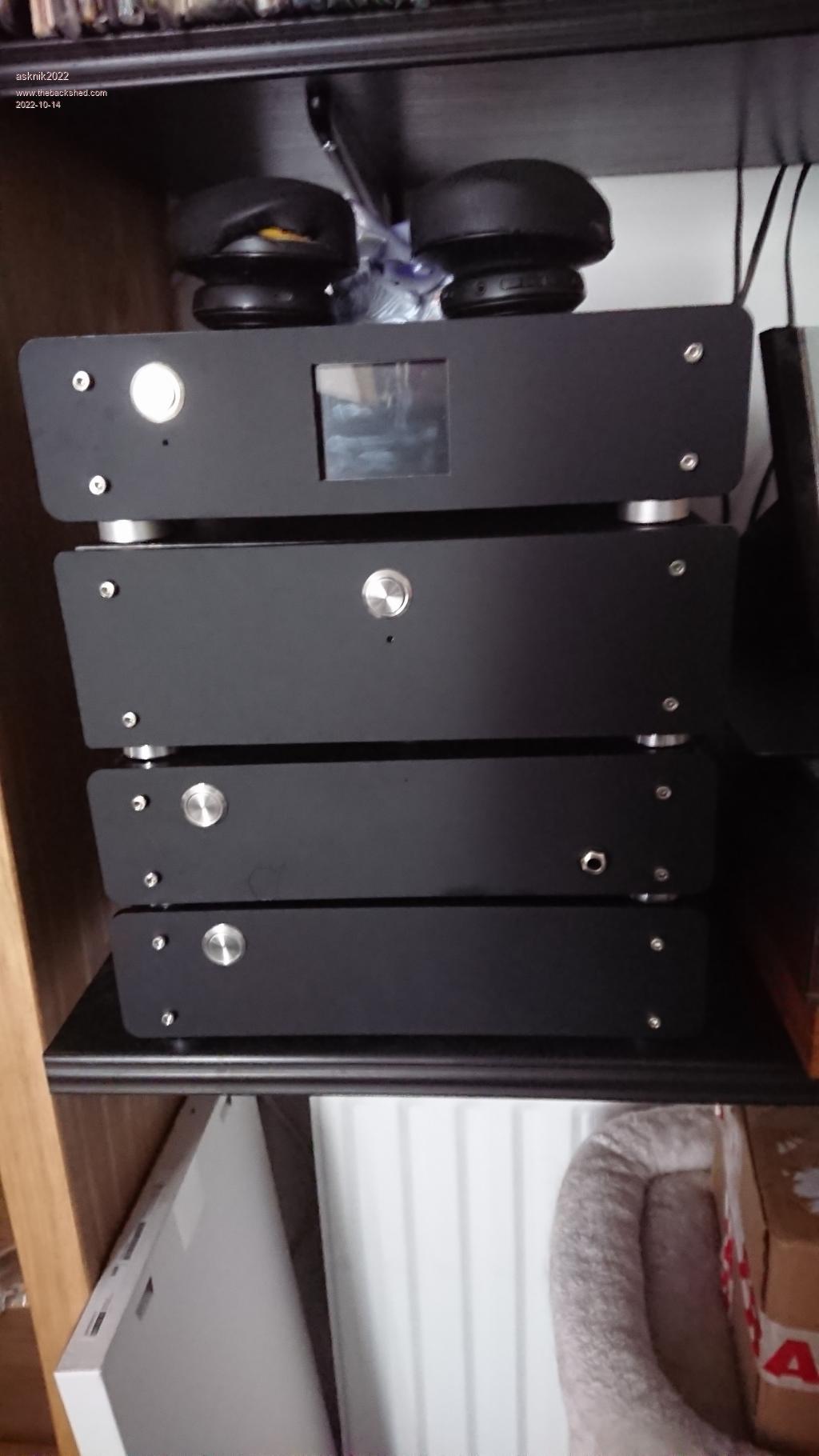

asknik2022
Joined: 26/03/2022
Posts: 94
Posted: 05:03pm 13 Oct 2022

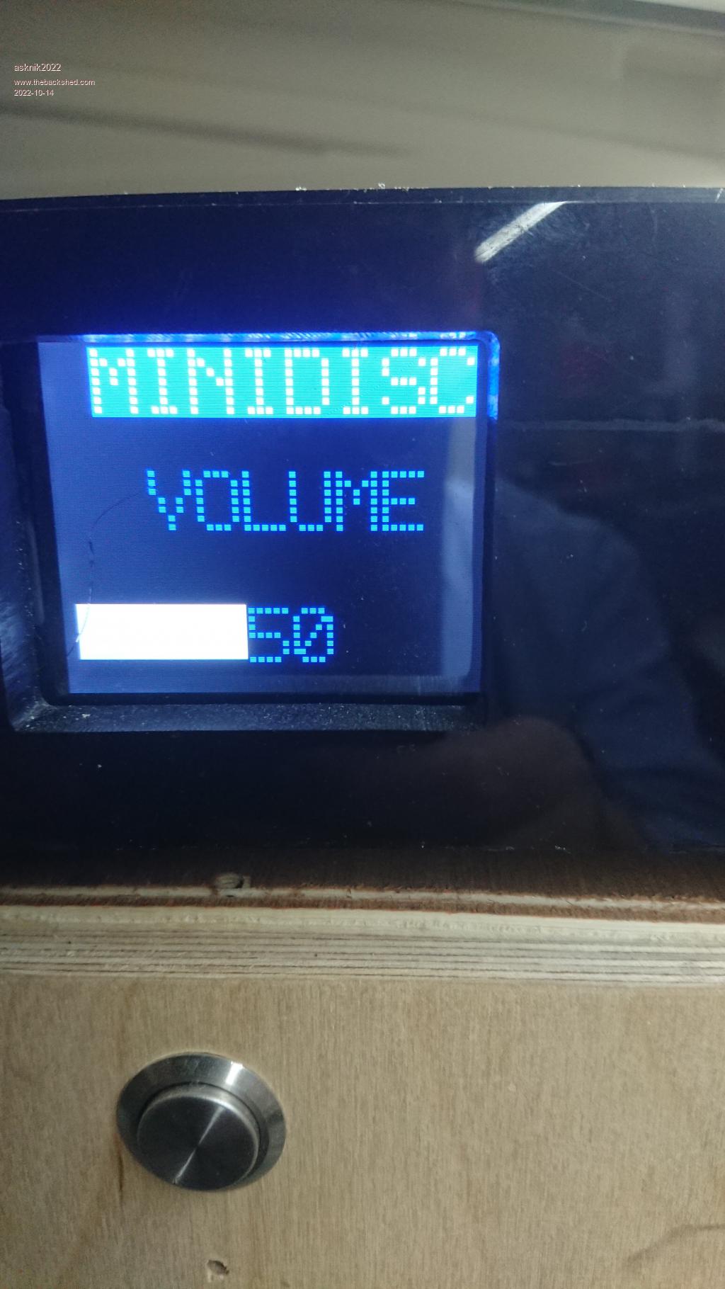

asknik2022
Joined: 26/03/2022
Posts: 94
Posted: 05:05pm 13 Oct 2022

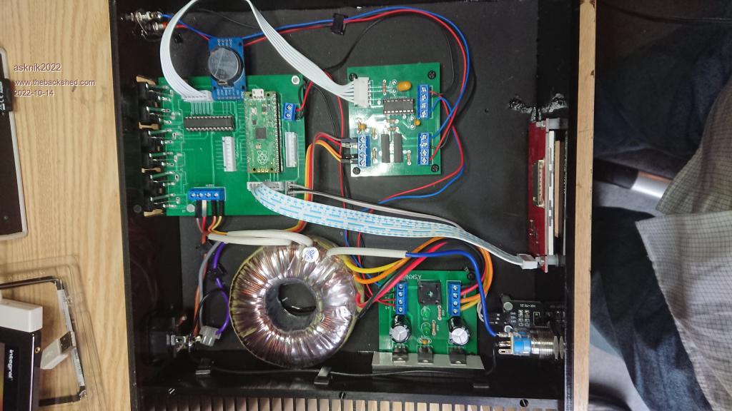

asknik2022
Joined: 26/03/2022
Posts: 94
Posted: 05:11pm 13 Oct 2022

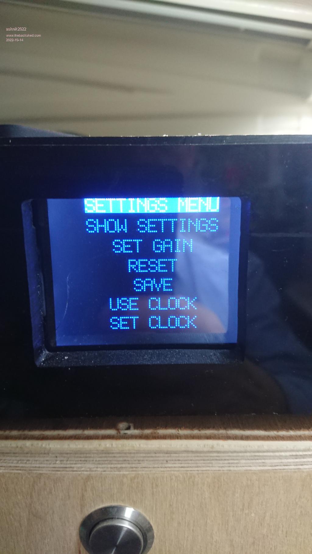

asknik2022
Joined: 26/03/2022
Posts: 94
asknik2022
Joined: 26/03/2022
Posts: 94
Posted: 05:12pm 13 Oct 2022

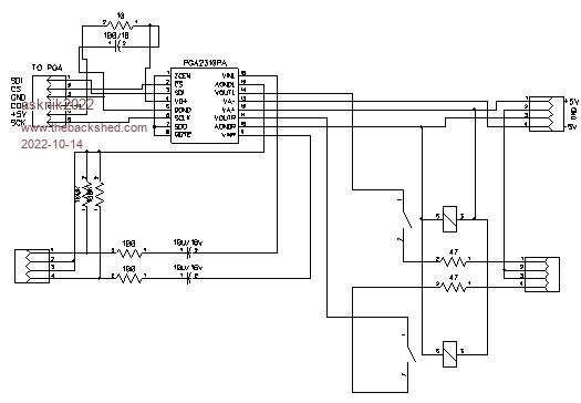

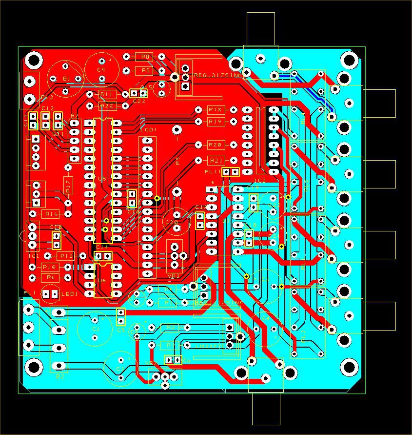

I did one years ago with a couple of Picaxe, one for IR and one to control relays and the PGA. The only issue I had was that the PGA2310 was noisy when used in amplifier mode but worked well when attenuating

Here is my circuit for the PGA2310 and I don't get any noise

Posted: 05:28pm 13 Oct 2022
