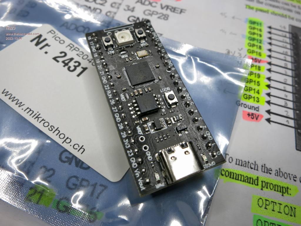

maybe a stupid question. But is it possible to use the 2 MB flash memory of the pi pico to store/load a ranking list (two small text files), or an image pic.bmp of about 250 KB? So you don't have to use an SD card.
By the way, i bought a pi pico that has a USB-C connector, an RGB LED, a user button and 8 MB QSPI (XiP) flash on board.
https://mikroshop.ch/Home.html?gruppe=3&artikel=2431
This pin compatible pico runs as expected so far. The RGB LED is accessible via GP23 and the button via GP24.
USB-C
USB-C
Agreed - but these things are all little extras that put the price up, which was why the original Pico doesn't have USB-C, apparently. Nice to have though.
