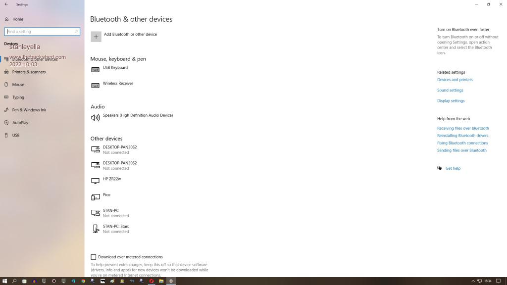

Please let me recap
Win10 devices just says pico as image.
putty needs a com number.
teraterm gives the option of 3 com ports, 1,2 and say 13 which is the pico so I use teraterm.
