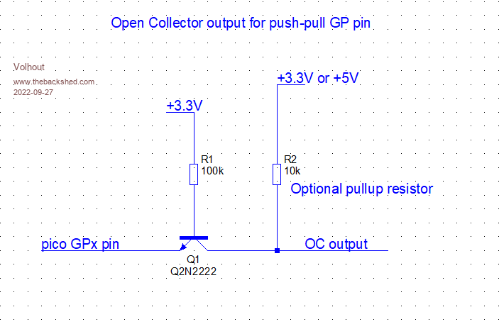

Posts: 6254
Posted: 11:10am 27 Sep 2022
@OA47
If you require this pin only to be OC output (not bi-directional) then this could help you.
The transistor can be any small NPN.

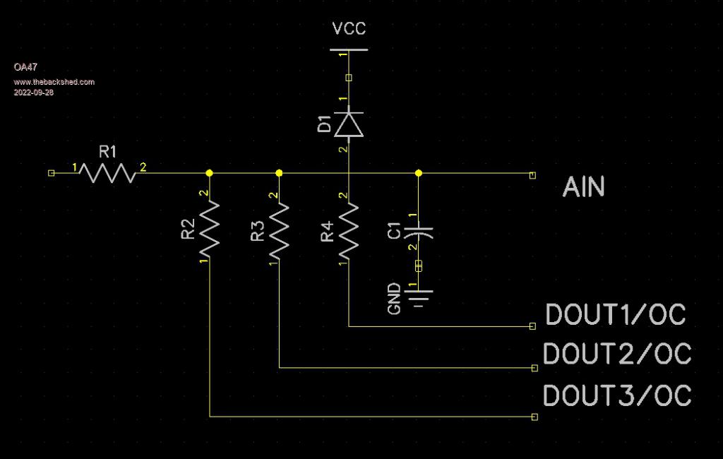

What I was trying to achieve is an auto ranging resistor network to measure DC voltages on the Analog IN pin. I have used this circuit on the ARMites and MicroMites.

For accurate readings the resistors need to be pulled to ground with a low resistance. The Pico pins are about 50 ohms, so even if OC worked accuracy would be reduced.
Use 2N7000 or similar MOSFETS to pull them to ground. Invert your DOUTs as a high will pull the resistor low.

  Quote  The Pico pins are about 50 ohms, so even if OC worked accuracy would be reduced.
I am not worried by the 50 Ohm resistance of the Pico pin as I use the software to calibrate the readings 0-100V. Typically in the past I used R1=1M0, R2=1M0, R3=100K, R4=10K.

Your circuit will work (I have used similar many times before), there is however one thing you should pay attention to. The protection diode. For this diode to work, it should be a shottky diode. And these tend to have high leakage (1uA). If you put that against 1Mohm input impedance, you will see a non-linearity error (that is also temperature dependent). That is why real multimeters use different protection methods, i.e. with silicon diodes (or even si transistors used as a diode) that have leakage currents in the pA...nA range.

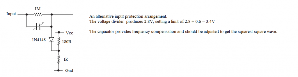

Assuming you are powering the PicoMite from a 5V supply, one way might be to use a resistor and 3V9 zener (or, even better, a proper temperature-compensated shunt regulator like a LM334Z) to an "over voltage" point and use a conventional silicon diode with it's cathode to that rather than to VCC. That would give you protection above 3V3 with a lower leakage.
