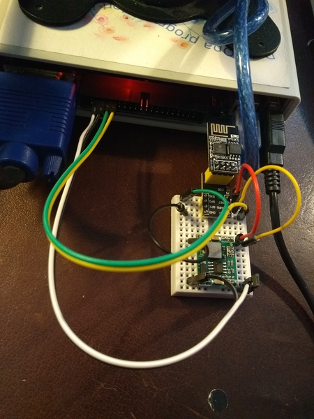

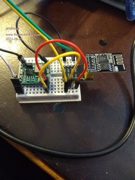

Hello,
I wanted to connect the Colour Maximite 2 to the internet.
My setup is an ESP8266 chip connected to ports 4,6,8,10 of the CMM2. Pin 8 & 10 are for TX/RX of com1: and pin 4 & 6 for VCC and GND. In between I put a dc-dc converter which generates 3.3 volts for the esp from the 5 volts comming from the cmm2. the TX/RX are connected cross over ("null modem") TX Cmm2 to RX ESP and vice versa. The ESP chip enable pin is sourced from the 3.3V comming from the buckboost converter.
a tiny "terminal program" gives the possibility to key in ESP8266_AT commands to test all the features:

And this is the result:
OK
AT+RESTORE
OK
ets Jan  8 2013,rst cause:2, boot mode:(3,7)
load 0x40100000, len 1856, room 16
tail 0
chksum 0x63
load 0x3ffe8000, len 776, room 8
tail 0
chksum 0x02
load 0x3ffe8310, len 552, room 8
tail 0
chksum 0x79
csum 0x79
2nd boot version : 1.5
 SPI Speed      : 40MHz
 SPI Mode       : DIO
 SPI Flash Size & Map: 8Mbit(512KB+512KB)
jump to run user1 @ 1000
??o?s?n|??|rl?s?l?l?l`?s?dl?l`?r?l???ll`sl?rd???cd?cr|bp`lcls?dco?nn?lpl?l?????ll?o???bl?p???cl?cpslrl
Ai-Thinker Technology Co. Ltd.
ready
AT+CWMODE=1
OK
AT+CWLAP
+CWLAP:(3,"WLAN-E6A414",-81,"9c:80:df:e6:a4:c4",7,0,0)
+CWLAP:(3,"hurz",-57,"98:9b:cb:2e:00:ec",12,11,0)
+CWLAP:(3,"TEST",-55,"9a:9b:cb:2e:00:ec",12,11,0)
OK
AT+CIFSR
+CIFSR:STAIP,"0.0.0.0"
+CIFSR:STAMAC,"c8:c9:a3:64:ef:2b"
OK
AT+CWJAP_DEF="TEST","SOMEPASSWD"
WIFI CONNECTED
WIFI GOT IP
OK
AT+CWAUTOCONN=1
OK
AT+CIPSTATUS
STATUS:2
OK
AT+CIPDOMAIN="WWW.THEBACKSHED.COM"
+CIPDOMAIN:223.27.28.33
OK
AT+PING="WWW.THEBACKSHED.COM"
+timeout
ERROR
AT+PING="WWW.GOOGLE.COM"
+13
OK
+timeout
ERROR
so, the www.thebackshed.com is not pingable
