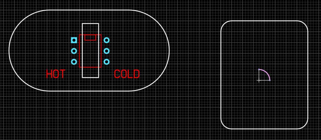

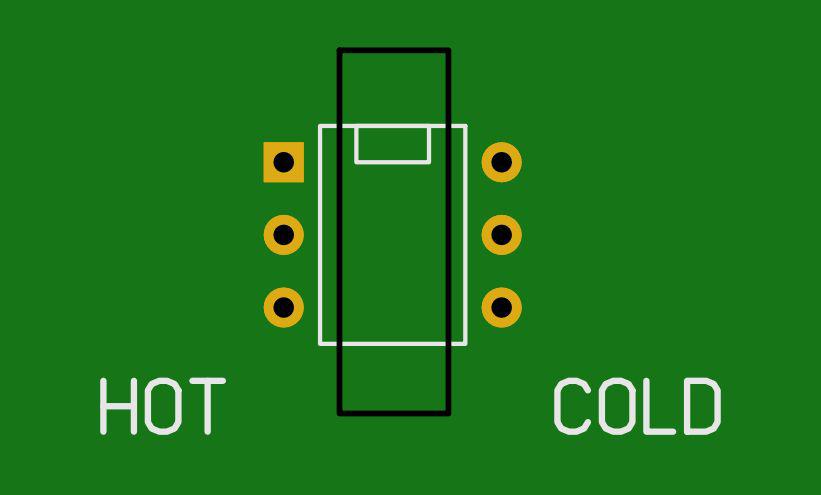

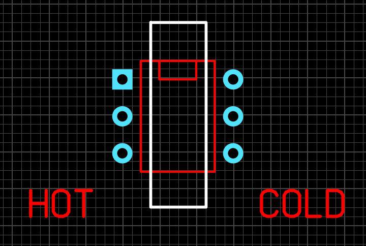

Further to what Mick said, making LARGE holes or cutouts in your board, is done by drawing the shape on layer zero.  If you wanted a 30mm hole in your board for a huge arcade-style button for example, you draw a circle with the circle tool, on layer zero.
EDIT: VERY quick example of a 6-pin DIL opto-isolator with a slot cut underneath it.  This is a 0.635mm grid, so the slot is 3.8mm wide.
Note the light-blue pads on the opto, meaning this part has plate-through holes, with pads on both top and bottom of the PCB.

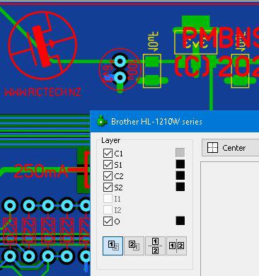

Confused about layer zero; if I draw a white circle, it doesn't show up as a hole on my print-out. I have to use a pad. What am I missing?
Graeme: Not sure if I grabbed a copy of your macros so please re-upload.
Craig
Posts: 10109
Posted: 06:25am 26 Sep 2022
Here are my macros as a ZIP file:
MACROS(Graeme's).zip
Layer zero is not printed, as normally you don't need it to show up in printouts, as it is a machining layer, not really a layer for showing on printouts.
To make it show up when you do prints of your layout, make sure that there is a tick in the "O" checkbox in the print preview window.
