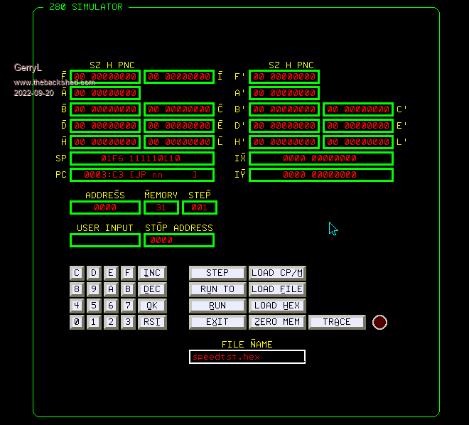

Attached is a zip file of a Z80 Simulator for the CMM2 I have been playing around with that others of my vintage may find interesting.  This will also run CP/M 2.2 which was originally placed in the public domain in 2001 (reconfirmed and clarified in July 2022)
http://www.cpm.z80.de/license.html
Note this is a simulator and not an emulator so I have not covered off on some of the hardware and it will ONLY run the Zilog ‘documented’ instructions. Can be run with or without a mouse. The CP/M side is using the original Digital Research assembly files dated Jan and Feb of 1980.
To assemble the CP/M files and build some testers I wrote a Windows Console macro assembler that I have included. The macro assembler is based on Digital Research’s 1980 CP/M Macro Assembler Manual. This will assemble both 8080/85 and Z80 instruction mnemonics.
This simulator was written as a fun project so I’ll guarantee there will be glitches and the assembler may not understand every way you can write an assembly instruction (the Z80 has about 694 legitimate combinations of opcodes and operands so there is bound to be a screw up somewhere). Also, it is not lightning fast, it runs about an average of 2.5 times faster than a standard 4MHz Z80, or a bit over 1 microsecond per instruction (of course the times depend on the instruction type).
For anyone wanting to have a play around the zip file contains a number of guidance instructions and examples.  The analog clock example is a good demo of using an in-line repeat macro in the assembly code to do all the heavy lifting during assembly in generating the pixel location tables for the minute tick marks, second hand line, and minute and hour hand triangles. Note I have not checked if inputting or setting CMM2 pins actually works as the intent of the project was focused on the software side.
I have a lot of fond memories of the Z80 and CP/M 2.2, my first encounter was back in the early 1980’s when work purchased some Prolog boxes with a STD Bus cage, power supply and two 8 inch hard drives. We used a Z80 ‘Little Big Board’ (manufactured by Pulsar in Melbourne) running CP/M 2.2. This was used extensively to log strain gauges using a compiled Microsoft Basic program. We also used a CMOS Z80 board manufactured by JED Microprocessors in Melbourne for field work, logging a range of sensors and GPS.

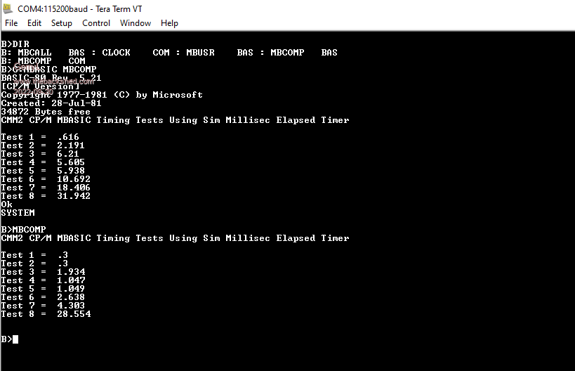

Below is the image of the main display panel and below that is a snap-shot of a Tera Term screen of using the TBS Benchmark Basic tests in CP/M.  The first set of times is running directly in Microsoft MBASIC while the second set of times is from a compiled and linked version.
