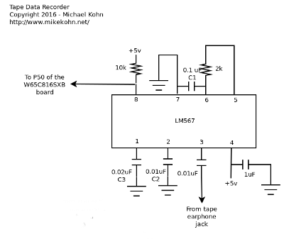

Classic = LM567 set to 1200Hz

  Volhout said  Classic = LM567 set to 1200Hz
circuit here, around halfway down the page:
http://www.mikekohn.net/micro/tape_data_recorder.php
you could feed the output from pin 8 of the LM567 straight into the console's RxD input. and to generate output to record onto the tape an LM555 may well suffice, changing between 1200Hz and 2400Hz (google "555 two tone") with the console TxD pin.
this way LIST would "save" a program, and AUTOSAVE would "load" it.
